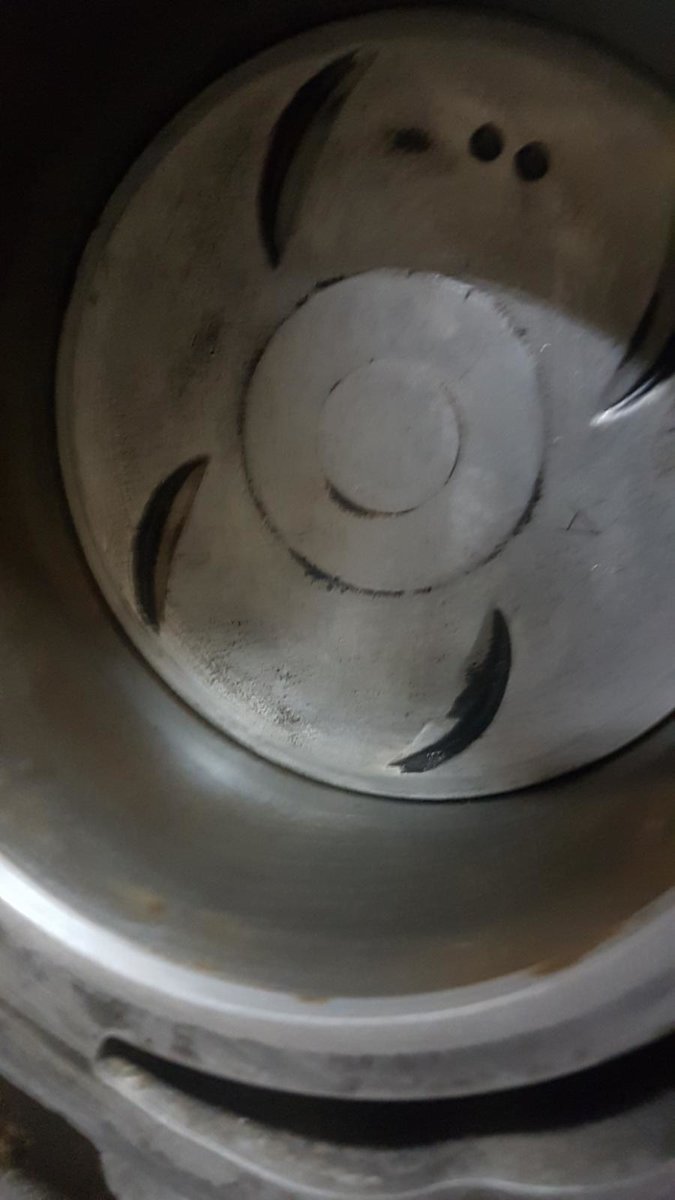

BGL Posted December 4, 2019 Share Posted December 4, 2019 Is there any way to visually differentiate an EJ253 short block from an EJ255 or EJ257 short block? I have no VIN, or any other information, available to help with the identification. Link to comment Share on other sites More sharing options...
nvu Posted December 5, 2019 Share Posted December 5, 2019 EJ253 will have an open deck. EJ255/257 will have semiclosed decks. The piston tops are different between the three. Link to comment Share on other sites More sharing options...
ocei77 Posted December 6, 2019 Share Posted December 6, 2019 There may be a vin stamped on the passenger side of the block. It is on a flat surface above the axle. Will have to clean first. O. Link to comment Share on other sites More sharing options...
logic23 Posted December 11, 2019 Share Posted December 11, 2019 the piston shape is the main way to tell. shoot us a pic of the pistons and im sure one of us can figure it out Link to comment Share on other sites More sharing options...
Numbchux Posted December 11, 2019 Share Posted December 11, 2019 On 12/6/2019 at 2:02 PM, ocei77 said: There may be a vin stamped on the passenger side of the block. It is on a flat surface above the axle. Will have to clean first. O. Expand This. Vertical surface on the RH side right next to the bellhousing should have the VIN (AFAIK, all the US-made ones have this). Link to comment Share on other sites More sharing options...
BGL Posted December 29, 2019 Author Share Posted December 29, 2019 Thanks everyone. Took a while to get access to the block again, and the cleaning tip revealed the VIN. 2003 U.S made, naturally aspirated 2.5. 1 Link to comment Share on other sites More sharing options...
