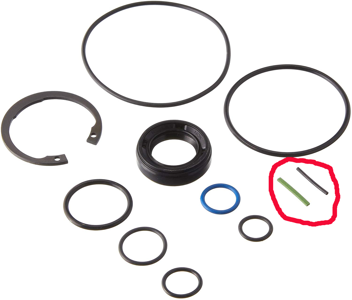

tylertrend Posted January 7, 2020 Share Posted January 7, 2020 Gates 348827 2005-2007 Leg/OB Link to comment Share on other sites More sharing options...

brus brother Posted January 7, 2020 Author Share Posted January 7, 2020 (edited) On 1/7/2020 at 2:25 AM, tylertrend said: Gates 348827 2005-2007 Leg/OB Expand I'm guessing I could figure out the o-rings, gaskets, and retaining clips but what are the two items circled? Guide pins?? Edited January 7, 2020 by brus brother Link to comment Share on other sites More sharing options...

idosubaru Posted January 7, 2020 Share Posted January 7, 2020 On 1/7/2020 at 2:25 AM, tylertrend said: Gates 348827 2005-2007 Leg/OB Expand funny, 05-09's are all interchangeable but the kit says only 05-07. that could mean additional replacement/rebuild options for OEM 08-09's as well. Link to comment Share on other sites More sharing options...
