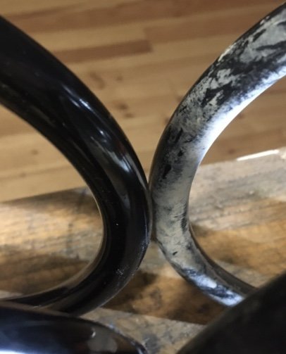

Mitchy Posted February 10, 2020 Author Share Posted February 10, 2020 (edited) Speaking of rear suspension, I just had my KYB springs delivered. They look good, and are certainly are about 10% thicker than the old SLS springs I pulled off the Silver Forester when I installed Pedders springs and struts some years ago. The rear springs on the green Forester are indeed the same thinner SLS springs, but with aftermarket struts, so they’re giving a really saggy butt! Can’t wait to get the new hardware on there! Edited February 10, 2020 by Mitchy Link to comment Share on other sites More sharing options...

Mitchy Posted February 25, 2020 Author Share Posted February 25, 2020 (edited) Well now, KYB Legacy Outback struts with KYB Forester SF springs has given me a surprising additional 2” clearance at the rear end. More than I was hoping for! The Outback struts are very similar in dimension to the Forester ones when put side by side, but obviously they must be stronger. They have a thicker piston rod, larger nut, etc, but it all fits into the original Forester top hat So these struts with thicker Forester springs makes for a good strong rear end on the Forester. I thought the struts I removed were aftermarket, but they have Tokico stamped on them. The springs were certainly softer than these new ones. Edited June 13 by Mitchy Link to comment Share on other sites More sharing options...

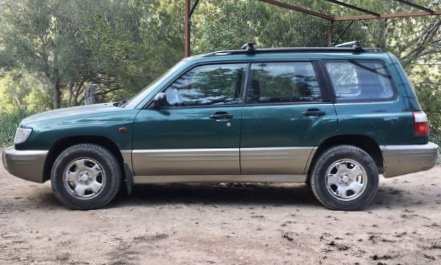

Mitchy Posted February 26, 2020 Author Share Posted February 26, 2020 Et voilà Doesn’t look like a huge difference in these pics. Front is not done yet. 1 Link to comment Share on other sites More sharing options...
el_freddo Posted February 26, 2020 Share Posted February 26, 2020 There’s definitely a difference in the rear. It should be good for what you’re after Cheers Bennie Link to comment Share on other sites More sharing options...
Mitchy Posted February 26, 2020 Author Share Posted February 26, 2020 Up-close the difference is considerable, I was quite surprised as I’m using apparently stock Forester springs, and the struts don’t appear to be longer. I’m not after a massive rock crawler lift, just the clearance necessary, so I’m happy. We’ll see if I need some spacers up front to level out the chassis. Tx Link to comment Share on other sites More sharing options...

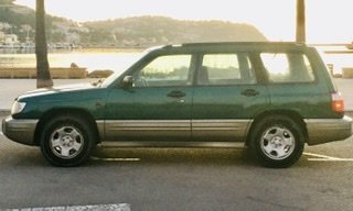

Mitchy Posted December 20, 2020 Author Share Posted December 20, 2020 (edited) Been a long while since posting here, whilst getting on with some building and family projects. The green Forester is now up on all four KYB OB struts, new Forester springs, slightly wider wheels and the ever so slightly larger than standard Yokohamas. It sits plenty taller than before. It is really fine on the road, firm, stable and those M+S Yokos really stick the brick to the asphalt. The only slight problem is the apparent topping-out going over some abrupt bumps. Edited June 13 by Mitchy Link to comment Share on other sites More sharing options...
Loyale 2.7 Turbo Posted December 20, 2020 Share Posted December 20, 2020 Do you have any Photo of the entire vehicle from a little far? Seems like it is on level now. Greetings from Honduras. Link to comment Share on other sites More sharing options...
