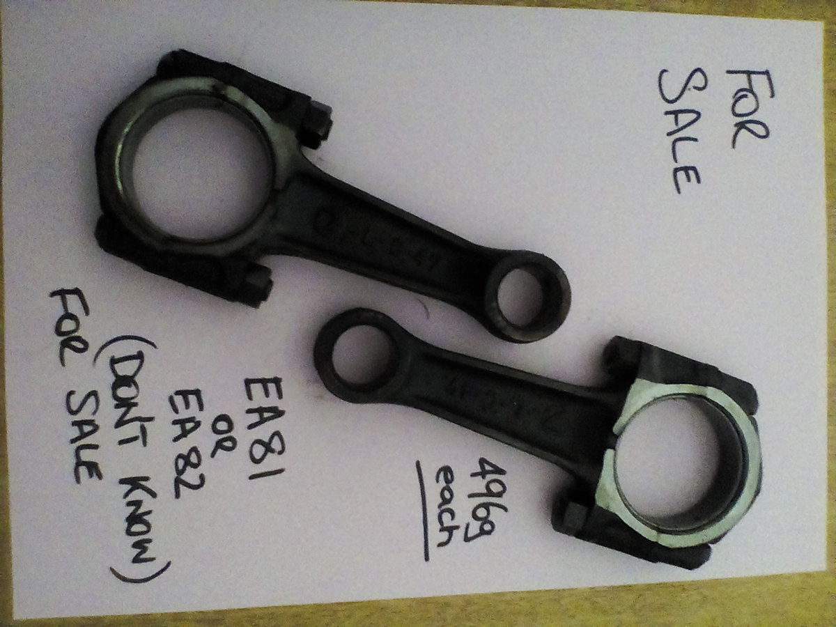

Steptoe Posted February 8, 2020 Share Posted February 8, 2020 (edited) Hey mate, just did a parcel quote via interparcel dot com Australia to Fairbanks AK zip ending in 01 out of about five optional codes Cheapest about A$35 Next one, carrier is your UPS A$49 I should look at expected shipping time eh? I used one kilo which could be two rods if I used styrofoam and tape. Or one and cardboard boxing and some fat allowance Think I sized dimensions as 200*100*50 mm Must have two more rods down in the shed if I can see Edited February 8, 2020 by Steptoe Link to comment Share on other sites More sharing options...
Steptoe Posted February 8, 2020 Share Posted February 8, 2020 Time of delivery if collected here tomorrow Monday for the UPS option of 49.50 maybe plus 10% GST Estimating Feb 19 th Convert USD to aud In USD about 3/4 the aud figure Link to comment Share on other sites More sharing options...
Steptoe Posted February 8, 2020 Share Posted February 8, 2020 (edited) Was it Ivansimports member here claiming EJ20 pistons fit EA engines at a better power-up? Though when queried, he had not actually done it himself. Someone revealed EJ piston crowns sitting in an EA82 they pulled heads off I think the EA con rod little end bushes need replacing with a bush that allows for EJ size gudgeon pin Edited February 8, 2020 by Steptoe Link to comment Share on other sites More sharing options...
