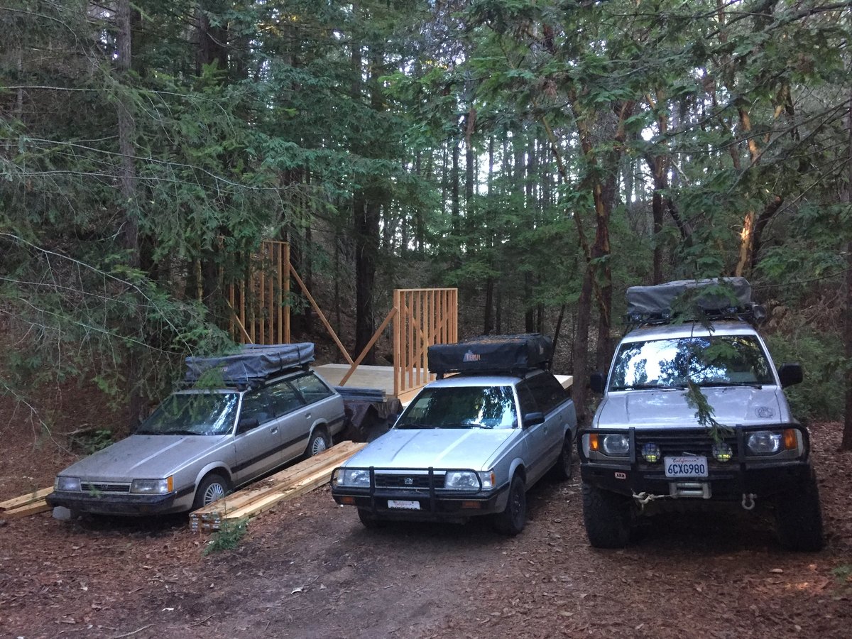

rallybru310 Posted February 6, 2020 Share Posted February 6, 2020 Ok, I finally scraped together some cash and am ready to move forward with my 81 wagon build. Before I do, I want to know of any questions that I don’t know to ask. As a newbie to building my old gl please help guide me away from any pitfalls I may face, I’ve driven them all my life but this is my first build! My highest priority is building a daily driver that is super reliable and maintains a stock look and feel aside from lift, wheels, and tires. My quiver for the build consists of: -81’ wagon which has a great body and interior. Has bad engine and bad 4spd d/r transmission. -86’ wagon that has a great body, interior, and 5spd d/r. Engine has low compression -90’ Loyale with good body, interior, and 5spd push button transmission. Bad engine. -96’ Legacy (not pictured) good 2.2 drivetrain. I’ve been planning on starting with the 81’ and using the 5spd d/r from the 86’ and the 2.2 from the 96’ along with a 4” lift. What are the downfalls of this combination for a super reliable daily driver? Are there better options? Are there any obsolete parts in this combo that would render it useless(ea81 oil pump)? Power steering or not, I love the feel of the manual steering with original sized tires but am concerned about 27”/28” tires. How does the a/c adapt? Which cross members should I use? Which axles will be best to use 81/86? SO MANY QUESTIONS!!!!!!!!!!!! I plan on driving this car for a long time, I want to get close to right the first go around. All input is welcome!!! Thanks Link to comment Share on other sites More sharing options...

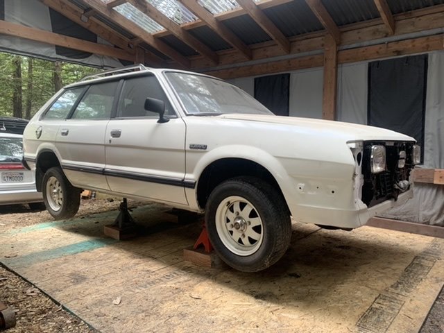

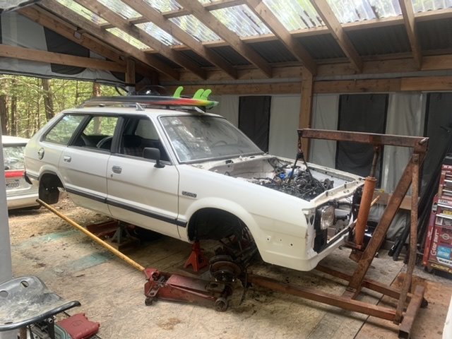

rallybru310 Posted February 23, 2020 Author Share Posted February 23, 2020 The transplant begins! 1 Link to comment Share on other sites More sharing options...

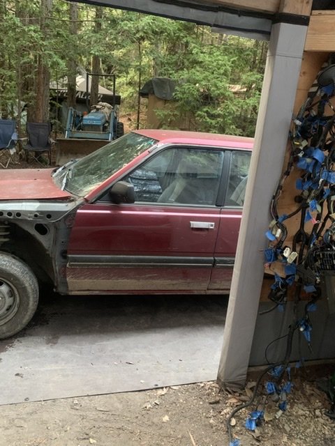

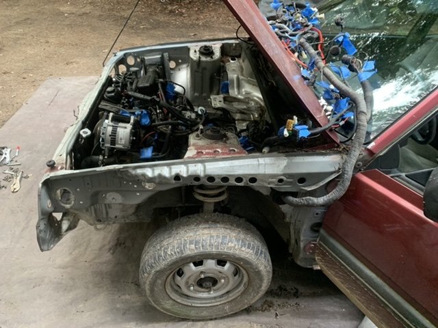

rallybru310 Posted March 9, 2020 Author Share Posted March 9, 2020 Thanks to Crazyeights misfortune we now have a second donor vehicle with many fresh components. I look forward to resurrecting what we can from “lil red”. We did let “lil red” stretch it’s legs one more time before we started dismantling it. We had so much fun on our first pass that we drove back down to the bottom of the mountain and went again, such a shame it got smashed! Thanks for everything Crazyeights! 2 Link to comment Share on other sites More sharing options...

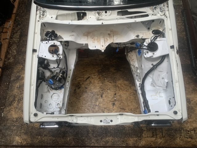

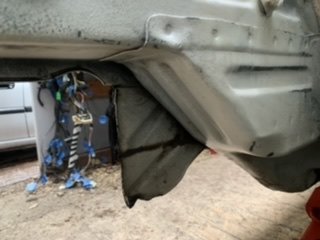

rallybru310 Posted March 10, 2020 Author Share Posted March 10, 2020 I came hone from work to find my son had finished unplumbing things and had totally labeled and removed the wiring harness!!! 1 Link to comment Share on other sites More sharing options...
Numbchux Posted March 10, 2020 Share Posted March 10, 2020 On 3/7/2020 at 6:14 PM, rallybru310 said: Hello again, In prepping for the EJ swap which electrical components can I remove from the engine bay? Should I remove all components and wiring including ecu and just leave the wiring for lights and accessories (wipers,horn,etc)? Thanks Expand The EA81 has very few electrical components that are specific to the engine, so you don't need to remove much. The vast majority of your time will be spent stripping and prepping the EJ harness 1 Link to comment Share on other sites More sharing options...

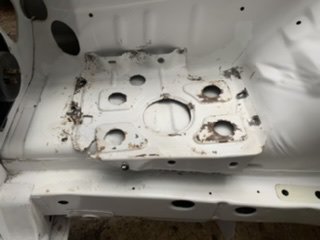

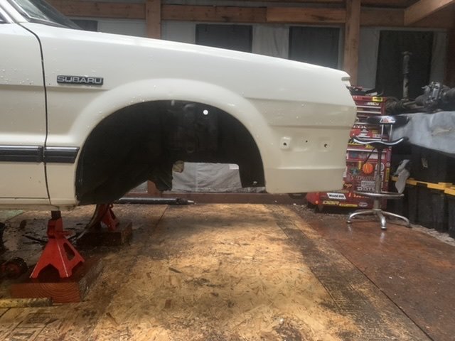

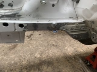

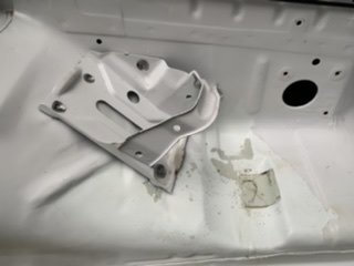

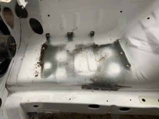

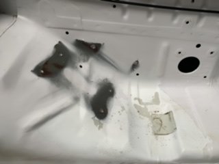

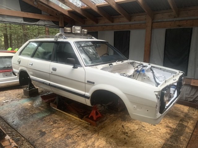

rallybru310 Posted April 7, 2020 Author Share Posted April 7, 2020 We finally had a little time to work on the wagon. Started cleaning out the engine bay prepping for paint, removed jack holder, battery tray, and a few other miscellaneous tidbits. Link to comment Share on other sites More sharing options...

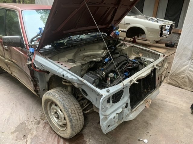

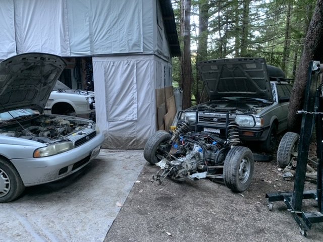

rallybru310 Posted April 15, 2020 Author Share Posted April 15, 2020 Hello again, I have everything setup to start removing all necessary equipment from the 96 Legacy donor vehicle in the morning. This is the 2.2 that will be rebuilt and installed in the 82 wagon. I’m planning on utilizing all factory emissions equipment to meet California smog requirements, with that said, I’m planning on hauling Legacy body away before swap is complete and I want to make sure that I harvest all necessary equipment before it’s gone. I’m planning on removing entire harness from ECU out, engine, all emissions under hood, fuel pump...Is there anything that I am likely miss? Link to comment Share on other sites More sharing options...
