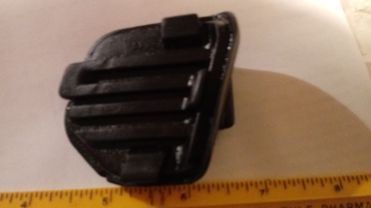

hunting around for source of oil leak on the top passenger side of my 05 Outback 2.5 non turbo auto and came across this little hard plastic ?cover plate wedged in towards the rear/side of the engine.
it's tight and dark down there and can't figure out where it originated or if it is even necessary.
going to hunt up a mirror to try and see a home for this plate.

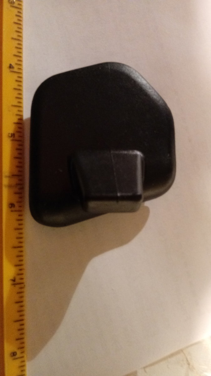

can only upload 2 mb so I will post again with the other view.

yup, access  cover to the torque converter bolts. Located below the throttle body to the passenger side.
don't know how it came out since it doesn't appear I will be able to reinsert it without removing the throttle body.

26 minutes ago, brus brother said:
Is there any hazard in leaving the cover safely stored in the glove box?
I throw it in the box of spare parts.
On our 95 and 97 RHD 2.2s they are hard as a rock and the tab that holds it in place breaks off. I can remember when they were pliable and would snap into place. Our 95 has 472k miles on it and that cover has been off since around 120k.
