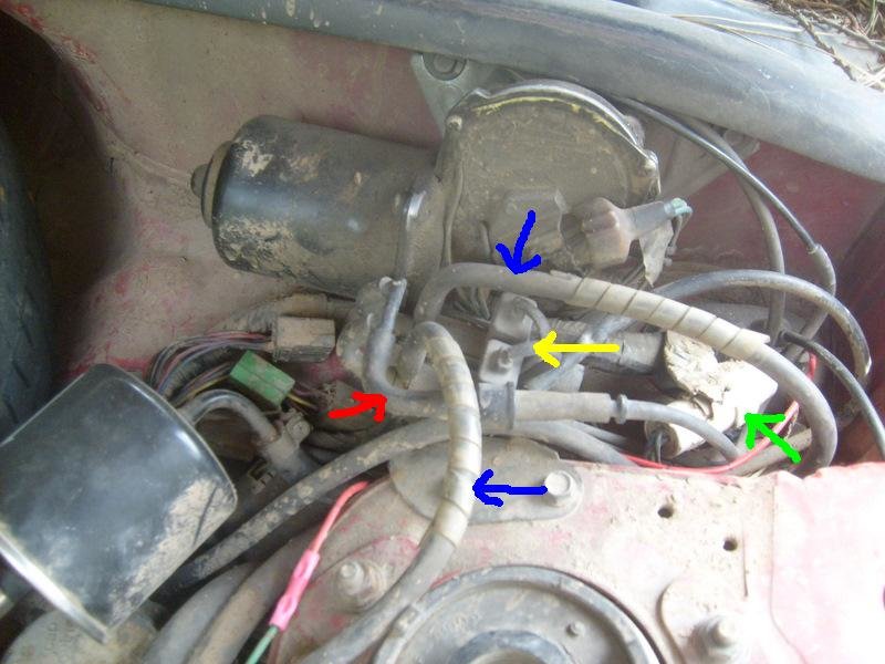

stoogesman Posted February 9, 2020 Author Share Posted February 9, 2020 These are the solenoids that sit I'm the engine bay up by the driver side firewall and strut. Link to comment Share on other sites More sharing options...

stoogesman Posted February 9, 2020 Author Share Posted February 9, 2020 Looking for the ones in this area. Orange and yellow arrows... Link to comment Share on other sites More sharing options...
Steptoe Posted February 9, 2020 Share Posted February 9, 2020 Something I am yet so see in the flesh. Vacuum solenoids would be a pretty close term Can I suggest you put up a want ad with that sort of wording in title? There are only so many ways a vacuum solenoids will work Some air just switching vacuum when powered up, possibly when power goes off. Two port pipe connections Some have a little hat on a third port so one side sees atmosphere when on or off You may want to look closer at what you have. Mark them to identify. If they share same wire colours and plug they may likely be the same if you have two working opposite each other. Test them electrical by adding 12v to them, see if they click or blow a fuse you added to the power up just then. Many cars this era used vacuum solenoids for all sorts of vacuum control. Most are 12 v but if ecu controlled may be 5 v ??? Many of us have found solenoids elsewhere to do the job....may need wiring correct plug Link to comment Share on other sites More sharing options...
el_freddo Posted February 10, 2020 Share Posted February 10, 2020 Both solenoids have the little atmospheric hat on one end. The other end goes to the diaphragm actuator. Then there’s a vacuum in hose line too. Cheers Bennie Link to comment Share on other sites More sharing options...
stoogesman Posted February 10, 2020 Author Share Posted February 10, 2020 1 hour ago, el_freddo said: Both solenoids have the little atmospheric hat on one end. The other end goes to the diaphragm actuator. Then there’s a vacuum in hose line too. Cheers Bennie Thanks ! I'm looking to purchase the car and the current owner says he thinks it's the solenoids. I'm leery to get and not be able to get them. Link to comment Share on other sites More sharing options...
