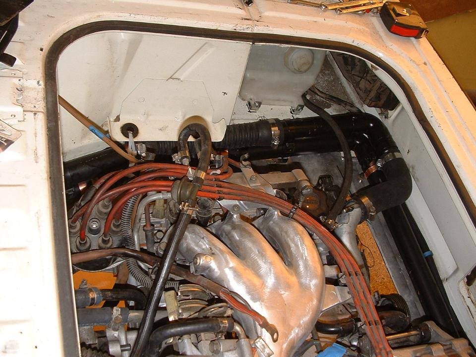

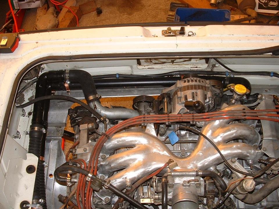

tjet Posted February 20, 2020 Author Share Posted February 20, 2020 Yes, there was a guy in Seattle that installed one in his Vanagon. I've attached some pics below. 1 Quote Link to comment Share on other sites More sharing options...
