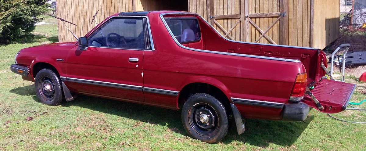

Jvandal Posted February 24, 2020 Share Posted February 24, 2020 Hi, new guy from TN. After wanting a BRAT for 40 years, finally got one... Sitting under a tree, "Ran when I parked it there".... Ignition switch broken so raided my stash and rewired. Now will run on fuel supplied directly to the carb but the fuel pump itself is very noisy and not pumping fuel. But I have a BRAT! and all sorts of plans for it..... VANDAL 2 Link to comment Share on other sites More sharing options...

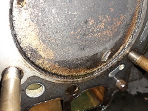

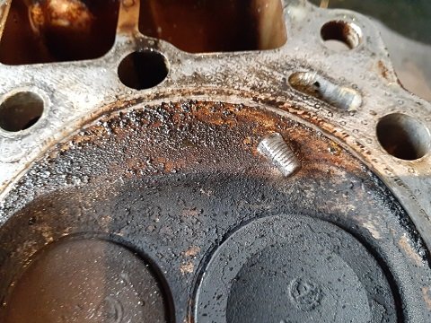

Jvandal Posted August 13, 2020 Author Share Posted August 13, 2020 Got it running... had a strange very unique "knock".... found this in Number 1.... all cleaned up and repaired.... on to fuel injection and super charger..... Joe Link to comment Share on other sites More sharing options...

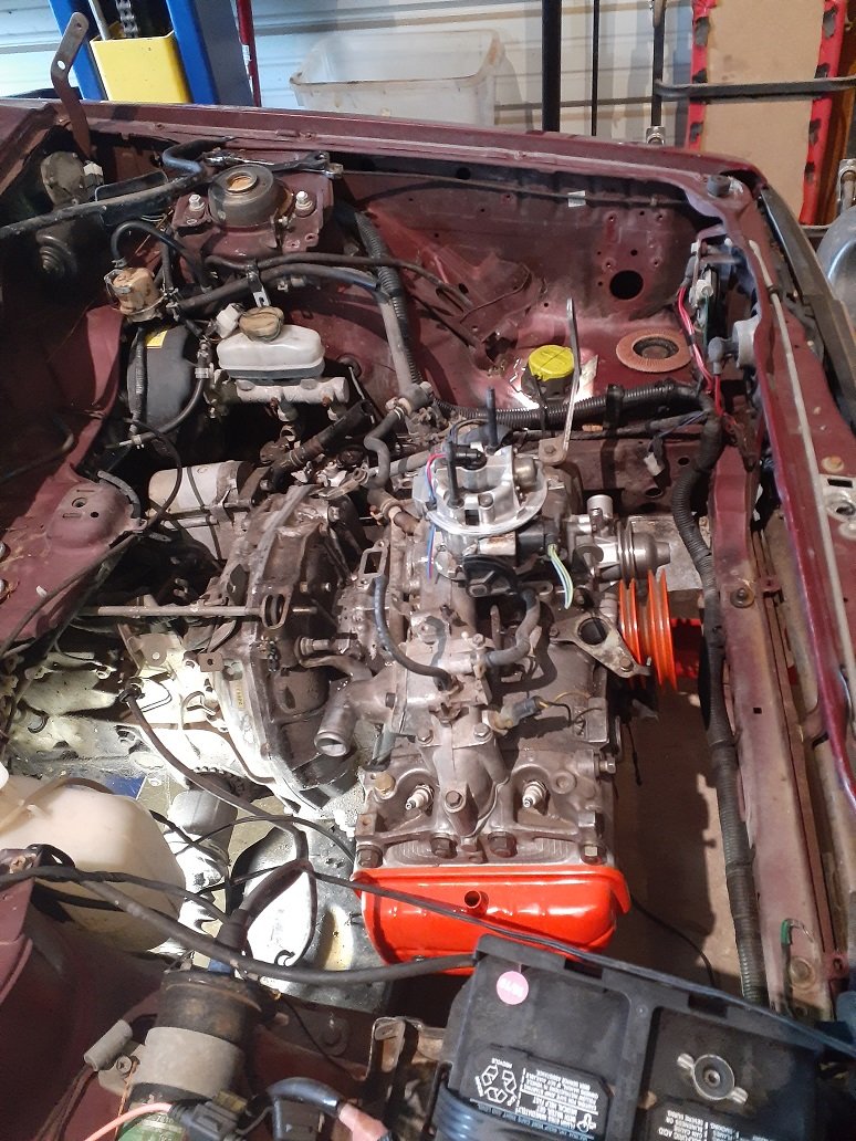

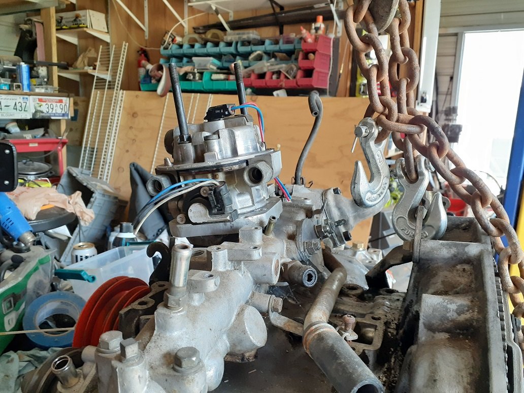

Jvandal Posted August 13, 2020 Author Share Posted August 13, 2020 Fuel Injection installed, TBI500 from a 1989 Pontiac Sunbird, controls by Microsquirt.... Now onto supercharger.... Link to comment Share on other sites More sharing options...
el_freddo Posted August 13, 2020 Share Posted August 13, 2020 (edited) Looks like an awesome project! The single port injection from the Pontiac is an interesting way to go about it. And was that a snapped bolt in the cylinder? That’d be annoying to say the least! Cheers Bennie Edited August 13, 2020 by el_freddo Link to comment Share on other sites More sharing options...
Jvandal Posted August 13, 2020 Author Share Posted August 13, 2020 (edited) 5 hours ago, el_freddo said: Looks like an awesome project! The single port injection from the Pontiac is an interesting way to go about it. And was that a snapped bolt in the cylinder? That’d be annoying to say the least! Cheers Bennie Yeppers, twisted off end of a 6mm bolt/machine screw.... Edited August 13, 2020 by Jvandal Link to comment Share on other sites More sharing options...
el_freddo Posted August 13, 2020 Share Posted August 13, 2020 6 hours ago, Jvandal said: Yeppers, twisted off end of a 6mm bolt/machine screw.... Where the bloody hell did that come from?! Very random. I’m glad you got onto it early. Cheers Bennie Link to comment Share on other sites More sharing options...
Jvandal Posted August 14, 2020 Author Share Posted August 14, 2020 Thanks, no idea where it came from.... but apparently was very new, at least at the time it was parked, I actually am guessing they parked it due to the "knock". Joe Link to comment Share on other sites More sharing options...
