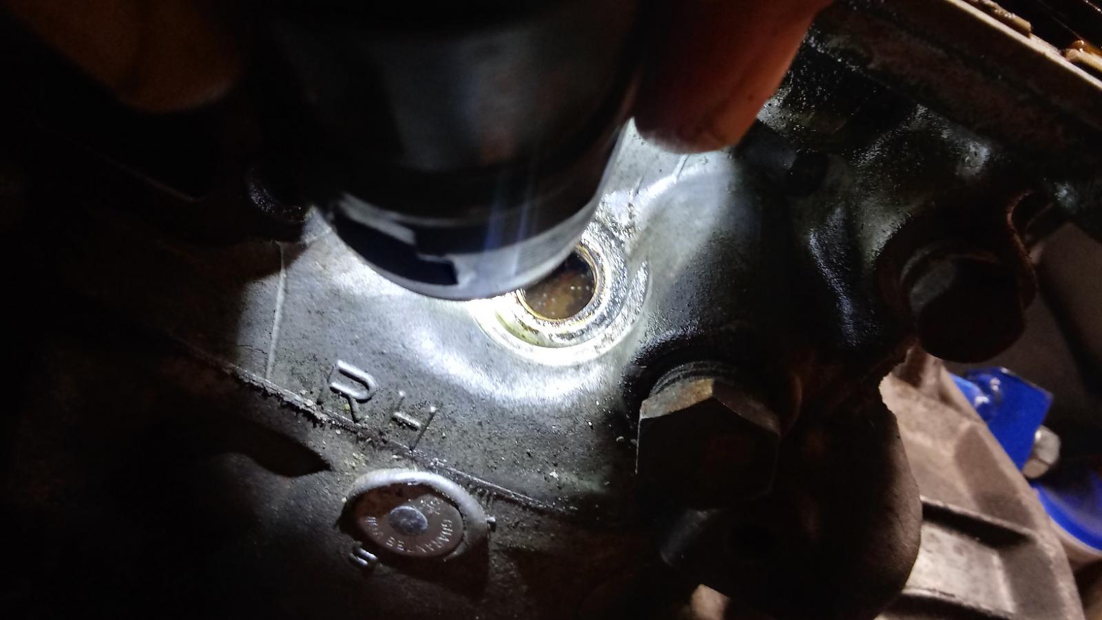

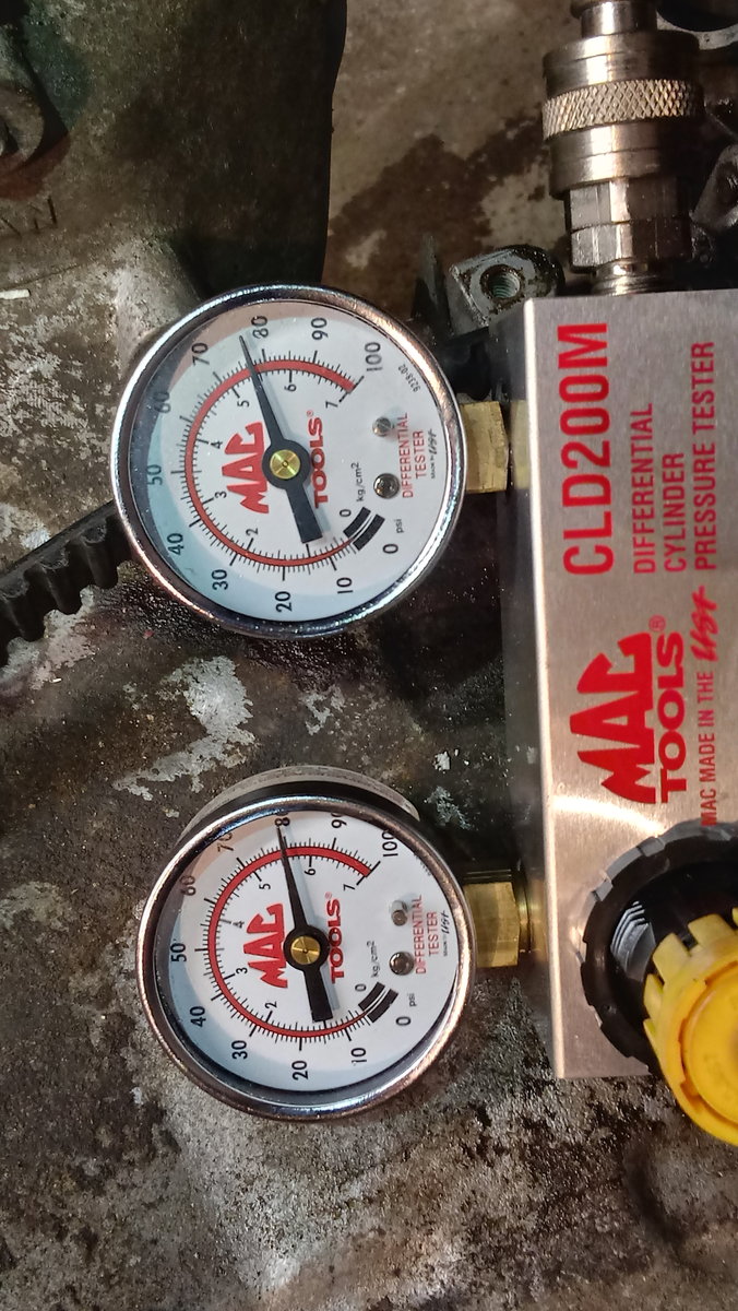

tjet Posted February 29, 2020 Author Share Posted February 29, 2020 So I did a leakdown test. All were reading close to this, except #5 cyl Link to comment Share on other sites More sharing options...

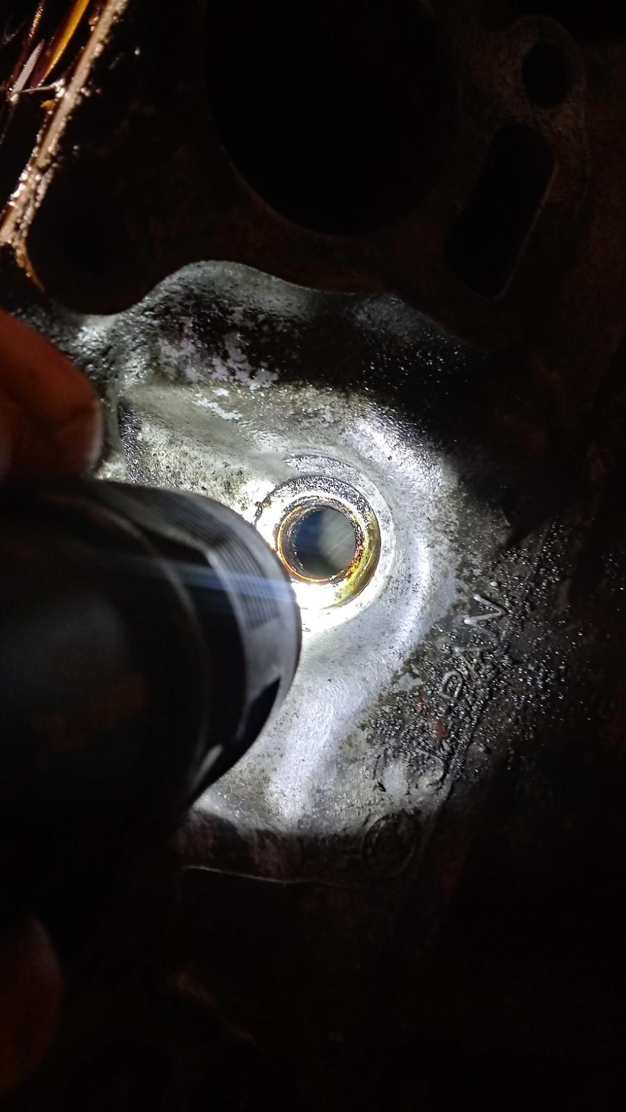

tjet Posted February 29, 2020 Author Share Posted February 29, 2020 (edited) #5... All other cyls show cross hatch Edited February 29, 2020 by tjet Link to comment Share on other sites More sharing options...
idosubaru Posted February 29, 2020 Share Posted February 29, 2020 I can’t tell what the photos of cyl 5 show? You probably know this but that engine has a warranty heat marker on it. It looks like it’s on the block so that block maybe has already been worked on before? Link to comment Share on other sites More sharing options...

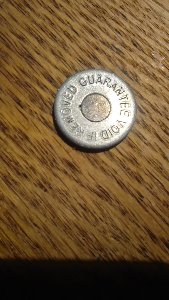

tjet Posted February 29, 2020 Author Share Posted February 29, 2020 (edited) Yeah i saw that. What is it for? Does the dealer put it on? It looks rusty in the #5 plug hole. I will pull the head in a few days & get some pics. here's that tag Edited February 29, 2020 by tjet Link to comment Share on other sites More sharing options...
Steptoe Posted March 1, 2020 Share Posted March 1, 2020 (edited) Wreckers have used these discreetly on used engines they supply in case of any warranty claims. Engine rebuilders also. Got a stash of these somewhere. The centre of the washer is like solder, if not solder. At certain temps it melts and falls out leaving tell tale sign the engine has been cooked. I failed to measure temp as it melted when I warmed one up on the furnace So where was the leakdown leaking? Could you hear it in intake, exhaust or crankcase? Edited March 1, 2020 by Steptoe Link to comment Share on other sites More sharing options...
tjet Posted March 1, 2020 Author Share Posted March 1, 2020 (edited) On 3/1/2020 at 11:06 AM, Steptoe said: ..So where was the leakdown leaking? Could you hear it in intake, exhaust or crankcase? Expand Seemed like the air was escaping thru the crankcase. I have the oil pan off, so it's not like I'm getting a stream of air from the oil fill. I will pull the head to investigate further. It's weird that the tag thing was glued right over the bad cylinder. Maybe just a coincidence. If I had to make a guess, the head gasket had a leak, which allows water to fill the cylinder while it was in storage. Edited March 1, 2020 by tjet Link to comment Share on other sites More sharing options...

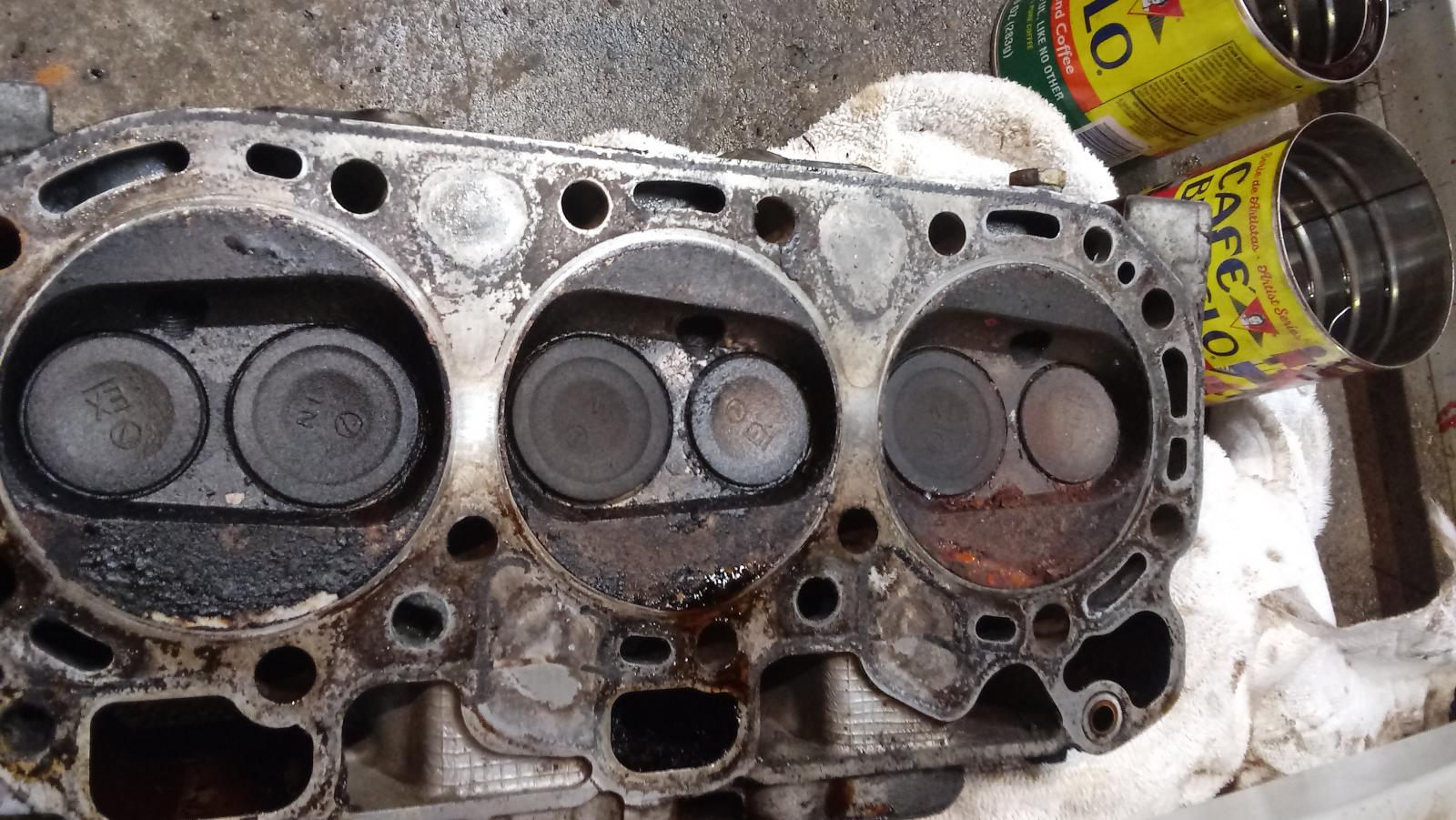

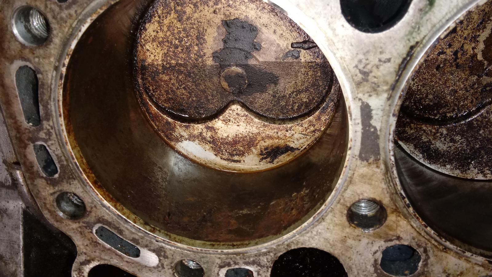

tjet Posted March 1, 2020 Author Share Posted March 1, 2020 (edited) So it appears that the engine leaked water into the #5 cylinder during storage this rusted the lower section of the cyl wall. The good news is that this engine has 5 head bolts per cylinder and a closed deck. How cool is that? . I think an EZ30 only uses 4 head bolts per cylinder. Edited March 1, 2020 by tjet Link to comment Share on other sites More sharing options...
tjet Posted March 1, 2020 Author Share Posted March 1, 2020 The head shows the same evidence Link to comment Share on other sites More sharing options...

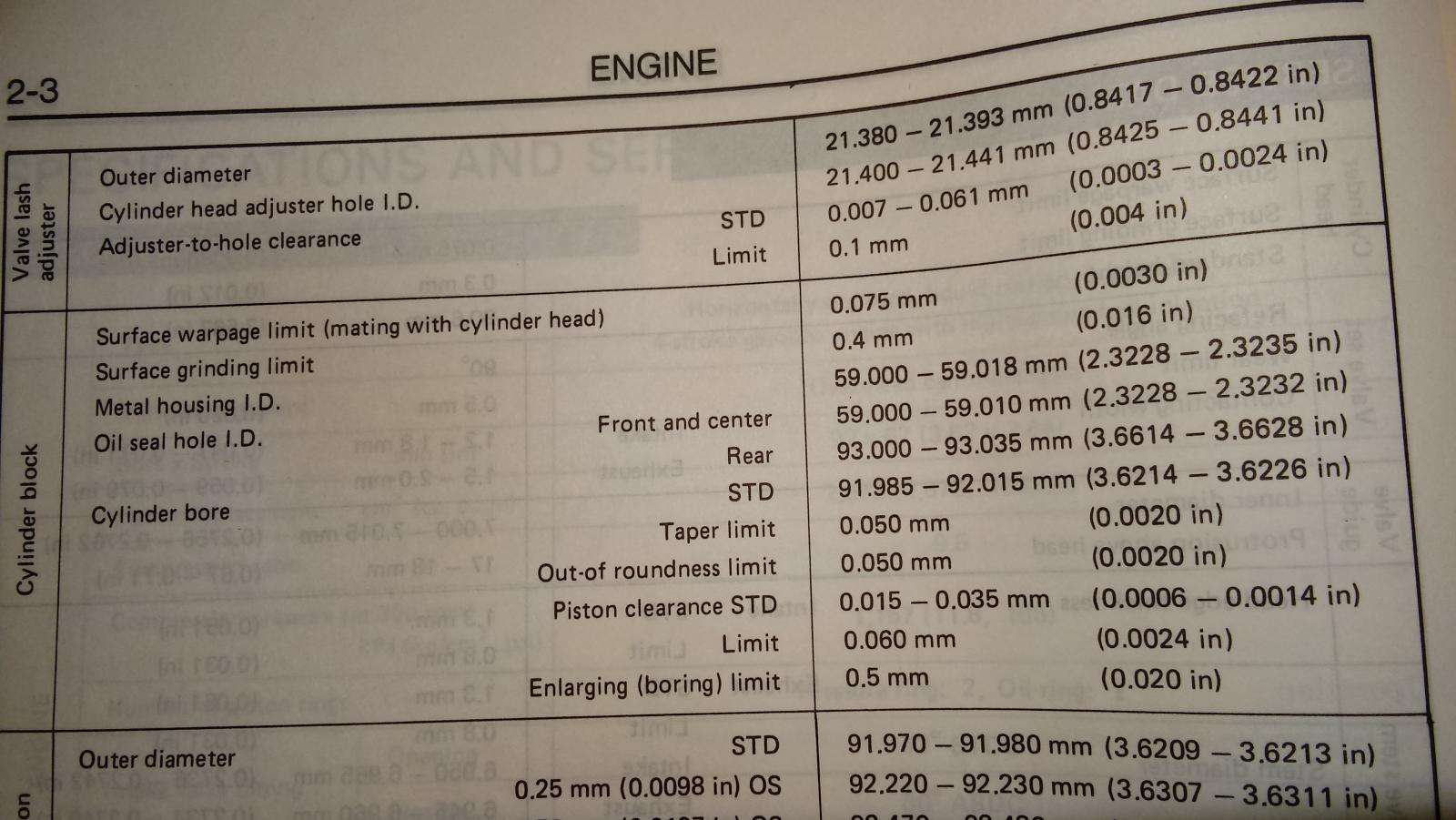

tjet Posted March 1, 2020 Author Share Posted March 1, 2020 (edited) It looks like the max bore limit is .020", So the factory bore is 3.620" + 020 = 3.640" ...Woohoo. I hope it will clean up. Edited March 1, 2020 by tjet Link to comment Share on other sites More sharing options...

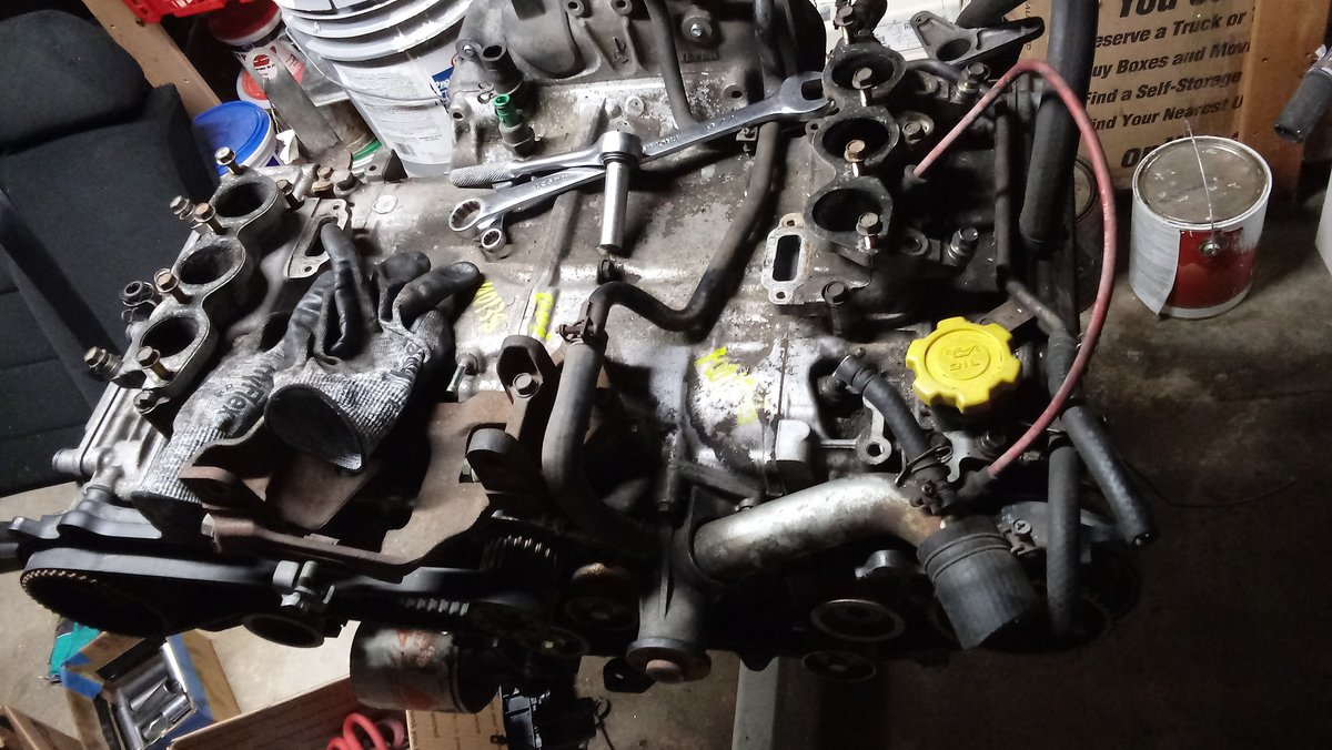

tjet Posted March 4, 2020 Author Share Posted March 4, 2020 Quick question: On this ER27, I've noticed various ports and nipples on the intake manifold, engine case, and valve covers. These are for water, vacuum, oil and breather. I would like to know what I can eliminate on this engine. Link to comment Share on other sites More sharing options...
