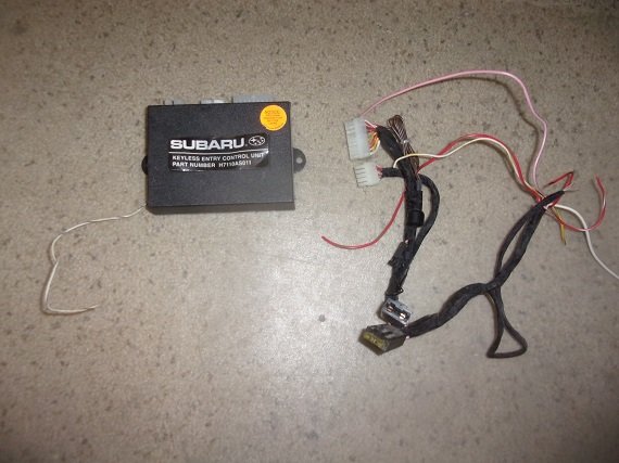

alykat Posted March 2, 2020 Share Posted March 2, 2020 97 Legacy Outback 2.5 Starts instantly runs several seconds,and dies. Key is still on, turn it starts instantly runs a few seconds and dies..repeat. Already replaced the fuel pump and filter. Ideas ? Link to comment Share on other sites More sharing options...
Rampage Posted March 2, 2020 Share Posted March 2, 2020 Our 95 and 97 EJ2.2 will do exactly the same thing when the MAF sensor is bad. Happened a couple of times. Get one from a yard. The last ones I pulled myself cost me $25.00 a peace. 1 Link to comment Share on other sites More sharing options...
alykat Posted March 8, 2020 Author Share Posted March 8, 2020 Turned out to be a faulty dealer installed keyless entry / anti theft system. Once I disconnected it and reconnected the cut and patched in wires in the original wiring, it starts and runs great. 1 Link to comment Share on other sites More sharing options...
