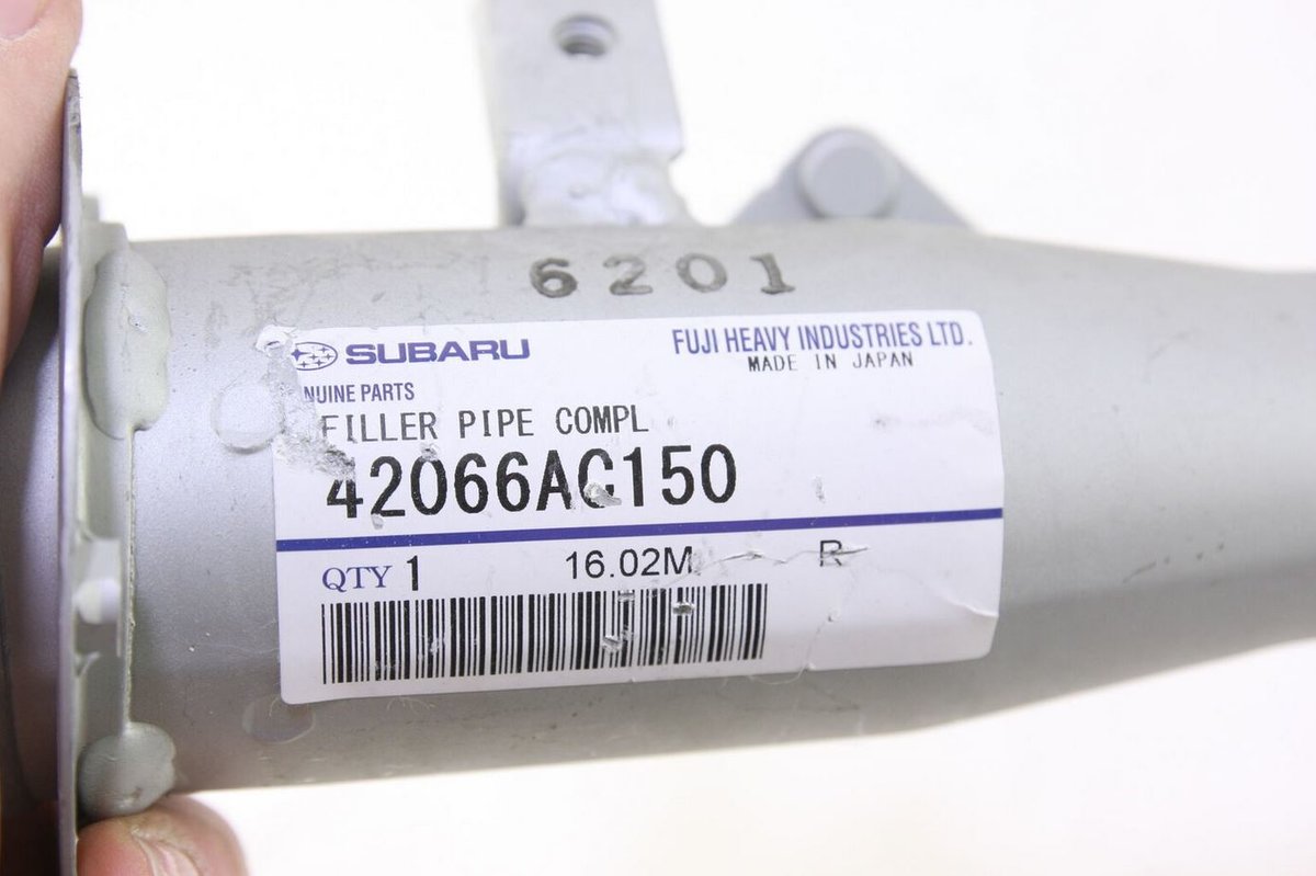

LeolaPA Posted March 9, 2020 Author Share Posted March 9, 2020 I have one in my watch list on Ebay 42066AC150. I still didn't see the car yet to look at the area. Since my daughter uses the car, I was hoping to have her mechanic replace it, but having to take the cover off is half the work of doing the job myself. May see her next weekend. I'll poke around and see what I can see. Do you people buy the big hose at the end from Subaru, or use something generic? Link to comment Share on other sites More sharing options...

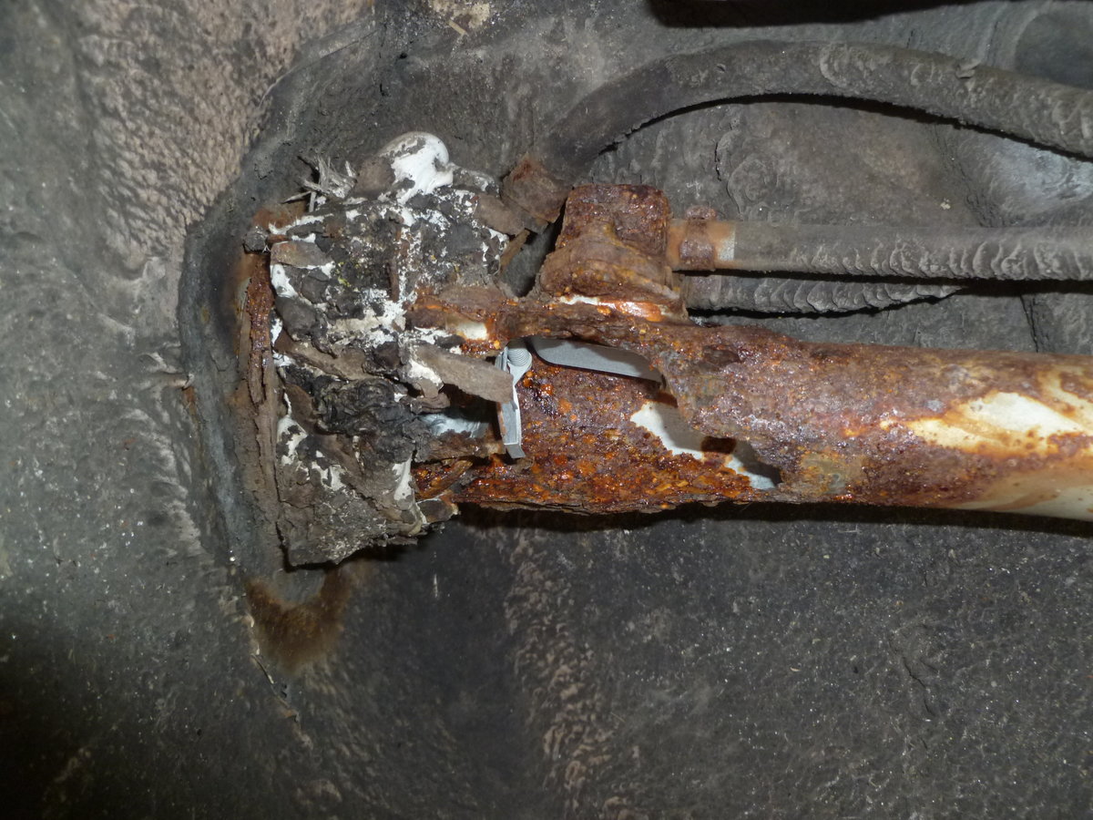

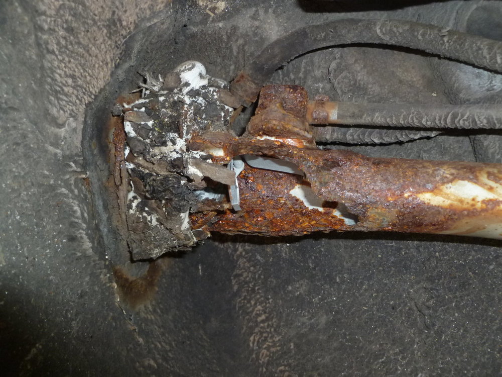

LeolaPA Posted March 17, 2020 Author Share Posted March 17, 2020 Thanks. I got the car home yesterday and took the plastic cover off today. The part looks to be the one that ends in 150, so I just ordered an OEM one that was on Ebay for about $63 plus tax. These days if you look at something on Ebay, likely you might get an offer in a day or two, and that's what happened on this. The filler pipe was half gone a couple inches below the little flap for maybe 5 inches. So I guess the filler nozzle was long enough that the gas was getting into the pipe beyond that hole. Numbchux it looks from diagrams that I will need the gasket. Not sure what else. There's a part bolted on up near the top that 2 hoses attach to . Not sure of the purpose but I'm hoping the part the hoses attach to is still OK. Link to comment Share on other sites More sharing options...

LeolaPA Posted March 17, 2020 Author Share Posted March 17, 2020 IdoSubaru and Heartless attached is a picture I took yesterday. Not sure how we've been getting gas into this car. Also you see the urethane caulk I put in there last year to hold the whole thing together. What a mess I made. But there was no time that day to fix the problem. Heartless attached is a screen shot of the part I ordered. I've done about 1,000 transactions on Ebay, so I'm pretty sure I'm OK with this. I DID order a solenoid and a new hose from this neck to the tank on Rockauto today. I did not know what the rusty box in the photo was, but apparently it is a SOLENOID and I'm sure ours is totally useless, so I ordered that. This job is sure complicated.... I likely will be getting parts by the weekend. Link to comment Share on other sites More sharing options...
heartless Posted March 17, 2020 Share Posted March 17, 2020 holy cow is that bad! I don't think I have ever seen one quite that bad, geez.. yeah, it is a wonder you were getting gas into the tank at all! genuine Subaru part, should be ok.. just make sure it has that same sticker when it arrives at your door. same scratches & everything. and yeah, that solenoid will definitely be toast, so good idea to order one of those as well. Good luck getting the old one off, at the very least you will probably need new screws (there are 3 that hold everything at the filler door) I ordered a replacement neck for my 02 Forester from Rockauto not too long ago, and the one I got came with the solenoid, outer plate, rubber gasket and new screws. I did have to tweak the lower part of the tube just a little to get it to fit properly, but for an aftermarket piece it was not bad, and solved my problems with not being able to fill properly. Link to comment Share on other sites More sharing options...

Numbchux Posted March 18, 2020 Share Posted March 18, 2020 Yes, that is just a check valve, it can clog and cause the gas pump to shut off immediately. On the cars with that, we always sold the nuts, too, as the studs usually twist off with them in the old one. On 3/16/2020 at 10:13 PM, LeolaPA said: The part looks to be the one that ends in 150, so I just ordered an OEM one Did you ever actually run your VIN on a parts lookup site (parts.subaru.com or partsouq.com both have VIN-specific lookups)? I'd highly reccomend doing that to make sure you've got the right one. Link to comment Share on other sites More sharing options...
LeolaPA Posted March 18, 2020 Author Share Posted March 18, 2020 30 minutes ago, Numbchux said: Did you ever actually run your VIN on a parts lookup site (parts.subaru.com or partsouq.com both have VIN-specific lookups)? I'd highly reccomend doing that to make sure you've got the right one. I checked by year and model, but just to be responsive to this question I checked by VIN today and it's the right one. 42066AC150 Link to comment Share on other sites More sharing options...
