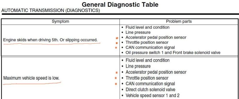

Rampage Posted March 19, 2020 Share Posted March 19, 2020 Because of the 40 mph symptom, I thought it might have something to do with torque converter lockup, but I found this in the FSM trans diag. section. The CAN is communication between all modules on the car. The signals go through a lot of connectors. I did not look, but the Factory Service Manuals always have a test procedure for the "Accelerator pedal position sensor" and the "Throttle position sensor". Link to comment Share on other sites More sharing options...
CityLights Posted March 19, 2020 Author Share Posted March 19, 2020 (edited) 16 hours ago, idosubaru said: Great. *** are these symptoms similar to before the trans swap or distinctly different? 1. if they’re different then maybe it’s something related to the swap work/new trans. A. Check fluid level. I know you have but verify it’s right and not loosing fluid B. Is the AT light flashing 16 times at start up? C. Make sure the front CV axles are fully seated. They need seated all the way. if the symptoms are absolutely 100% Identicial we need to consider what non-trans item could be a culprit. So here’a an update, I got all my tires done, donut is off the car, same symptoms prior to the tires. A; the symptoms are indeed the same prior to the trans swap, but again, after the swap the symptoms disappeared entirely for a short while. B; I don’t believe so. Would that be the sport light? All lights come on the dashboard but as all the systems check off they turn off one by one. All fluid levels are the same. I’m not losing any fluid All appears to be well in that regard. C; All axles are seated properly. Although, I did make an observation on my rear differential. The passenger side is covered in oil. Specifically where the axle inserts into the diff. This is the side where the donut was on the car, but also, a couple months back the shock went bad and the car was only supported by the spring on that corner. The car was bouncing all over the place cause of that. I drove it lightly for 2 weeks like that before the new ones came in and I replaced both rear. That was back in late october if memory serves me right. Could the rear differential be going bad? Would that possibly cause these issues? With the new and balanced wheels and tires I do still notice a slight shaking coming from I think the rear of the car. Edited March 19, 2020 by CityLights Link to comment Share on other sites More sharing options...
CityLights Posted March 19, 2020 Author Share Posted March 19, 2020 15 hours ago, Rampage said: Because of the 40 mph symptom, I thought it might have something to do with torque converter lockup, but I found this in the FSM trans diag. section. The CAN is communication between all modules on the car. The signals go through a lot of connectors. I did not look, but the Factory Service Manuals always have a test procedure for the "Accelerator pedal position sensor" and the "Throttle position sensor". Thank you!! I will give these a shot this weekend!! I noticed my engine once warmed up appears to be idling lower than it used to. It used to idle around the 750rpm range but now the dash reads 500 and hooking a OBD reader onto the car reports the idle to be 650-690 Link to comment Share on other sites More sharing options...
