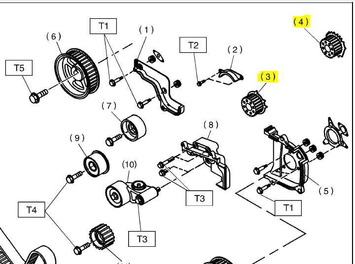

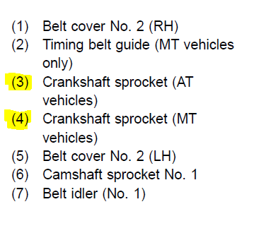

heartless Posted April 18, 2020 Share Posted April 18, 2020 got curious and went looking at FSM info here: http://jdmfsm.info/Auto/Japan/Subaru/ looks like the 2001 had 2 different crank sprockets - one for auto, one for manual.. where the 2003 only used one version for both.. so it would appear that for a manual, you need the crank sprocket with many small teeth Link to comment Share on other sites More sharing options...
1197sts Posted April 18, 2020 Author Share Posted April 18, 2020 Thanks for all of the input, appreciate it. The correct crank sprocket for the '03 MT Outback is the one with fewer teeth, and the cam gear has 6 nubs on it rather than 2 on the '01. The car starts and runs. I had assumed the MT always had a different crank sprocket than the auto, but it does look like the '03 has the same one that I've seen on many of the AT Outbacks. Link to comment Share on other sites More sharing options...
