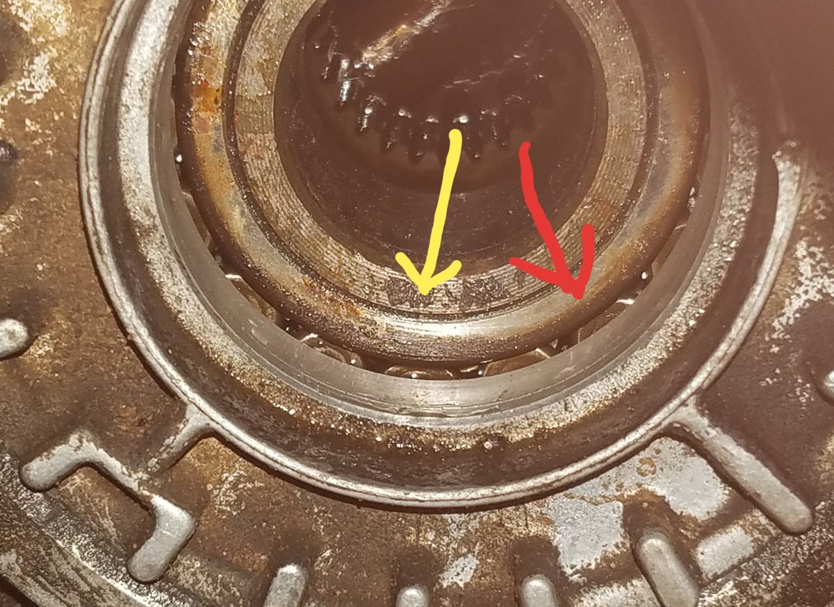

Alright guys. Appreciate the insight. Sorry, I lost the link back to this page so I just now got around to seeing your responses. We went ahead and got the axles swapped out under warranty just because we had to go get other parts as well, but will definitely look into rebuilding an OEM set. Tires are 100% not the issue, I've had them all replaced since this issue had started in September. It's just gradually getting worse. Also, drained the front diff and changed fluid today, had a minor amount of metal on the magnet. Inspected the gear you can see through the drain hole, no obvious damage to that particular gear, but if you were super critical there were some minor irregularities, but no sticky spots. Is it normal for the splines the axles slide into to have play side to side? If I stick my fingers in both sides and press the gears towards each other, it definitely causes some binding to occur. Waiting in my seals to come in before i can do anything else right now. And also, immediately after the axle seal, there is what looks like a bearing. I cant get either side to turn. Is that actually just a guide or is it a bearing? I looked at the exploded diagram from subaru and they say there is a bearing there but when I look at the bearing itself on their page, it doesnt look exactly the same. I'm seeing like an extra sleeve through the bearing or something. So my question is does that bearing just have the axle go through the middle, or is there some sort of sleeve that's holding that bearing. Idk how to say what I'm trying to ask. Lol. I'm poor as codswallop and am trying to get back on my feet and this is my work vehicle. I'm just concerned about that bearing and the gears being able to be moved sideways. They dont wiggle at aa angle, just slide straight. I'll put a picture of the bearing thing im seeing tomorrow if needed. Thanks for the help guys, I just cant afford to replace the axles and find out the trans is fkd. I'm barely in a position to buy anything at this point

Ok. So, I have access to the tool the junk yards use in my area to find and share parts with each other, and they're wanting $65 for each axle. Would you be willing to ship me 2 of them if I paid you through paypal? I think we are going to try these axles first however, like I said, definitely trying to make this as cheap as possible. Our axle seals were bad, so I'm hoping that could perhaps be the culprit. And as far as there being sound, theres a slight clack clack sound when I put the car in the air and in gear, no wheels on. While driving you couldnt hear a clacking noise, but there was a loud sound similar to a truck with mud tires driving on pavement.
Yellow arrow points to what I am asking is supposed to turn or not. I expect it to be stationary and believe the red arrow to be pointing at a bearing. But is the yellow arrow supposed to move or not?
