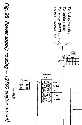

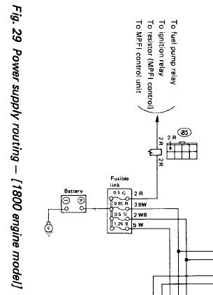

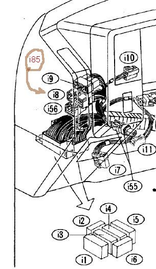

Rampage Posted May 12, 2020 Share Posted May 12, 2020 (edited) I am using the FSM for an 88 XT. Hope your 89 is similar.http://jdmfsm.info/Auto/Japan/Subaru/--Old Models--/ For the radio- Check fuse #5 - 15amp. It supplies constant 12 volts to the solid white wire on the radio connector. It goes through 3 connectors to get to the radio plug. It also powers these circuits Auto antenna, Horn, Diode box, Height control unit, Hazard, Trunk room light, Radio, Trip Computer, Clock, Automatic seat belt unit, Key warning switch. Green Fusible Link- see pics. Check voltage on both sides of red wire on connector i85(aka i8). Left side of dash. The wiring diagram shows a connector number, then you go to a chart to get the location number. Weird. Edited May 12, 2020 by Rampage Quote Link to comment Share on other sites More sharing options...
