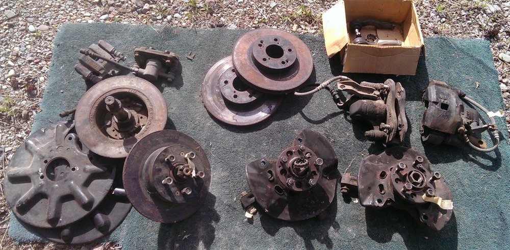

gpilot Posted May 10, 2020 Share Posted May 10, 2020 (edited) ***SOLD*** Well, timing is everything as they say... I began my spring cleaning today. I have these from an 89 xt6, I sold the xt4 before getting to this conversion. Front knuckles , L + R, with 5 lug hubs. Bearings good, seals will need to be replaced Front calipers, L + R Rear backing plates Rear calipers L + R Front brake rotors (2) Rear hubs with the 5 lug hub and stub axle (2). Bearings good but same with the front seals, you will want new ones. Surface rust on the parts, they have been sitting for 8 years (indoors) but nothing deep.Rotors have plenty of wear left. Most of the bolts and hardware. I was going to post here, I haven't been on this forum in years and say your post. PM me if interested, I do have a photo. If I do not hear from you I will probably post in the for sale section. Greg Edited May 30, 2020 by gpilot sold Link to comment Share on other sites More sharing options...
