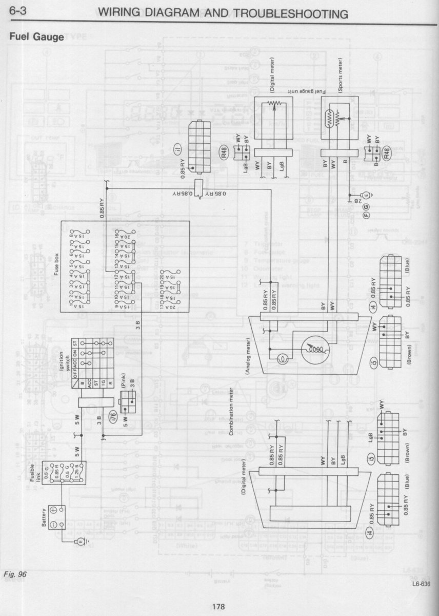

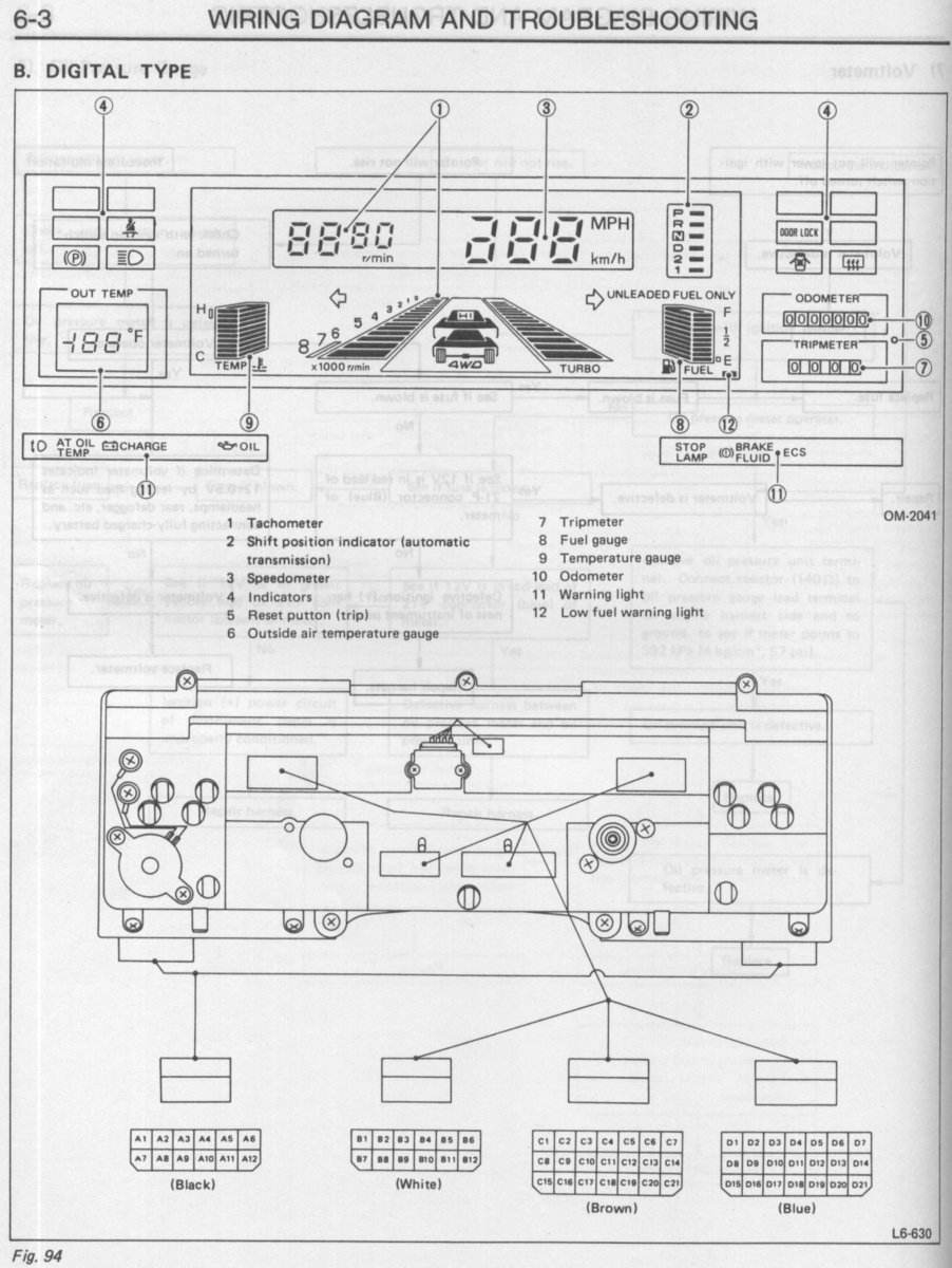

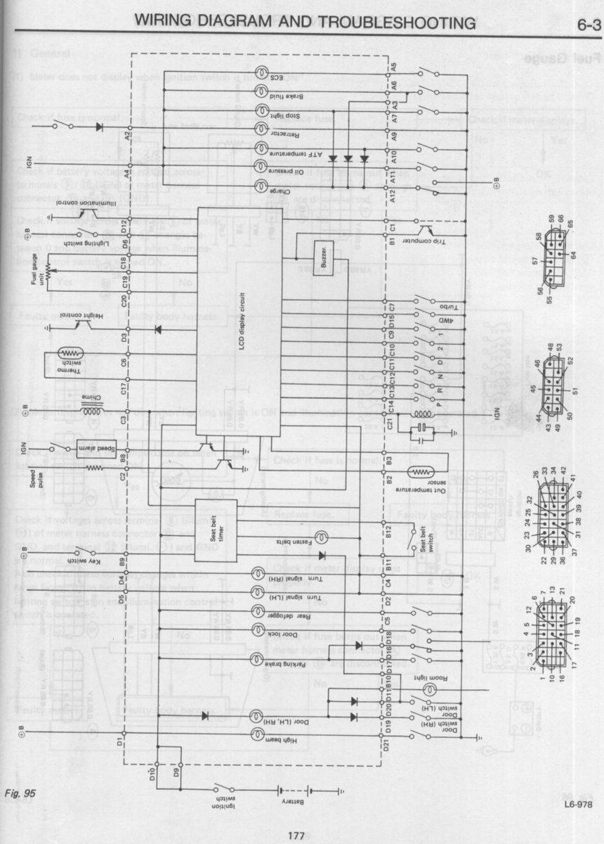

Masterofreach Posted May 14, 2020 Share Posted May 14, 2020 Currently working on putting an XT Turbo (1987, I believe) digidash in my '89 XT6, looks like I gotta repin some stuff, so I'm hoping someone here can help me locate a FSM or diagram pre-1988 that has the digital instrument cluster wiring diagrams. Also any tips on tachometer/fuel sender/temp sensor are greatly appreciated! Link to comment Share on other sites More sharing options...
DaveT Posted May 15, 2020 Share Posted May 15, 2020 My 86 FSM has XT sections. I have seen an XT or 2, never worked on one. I do know SPFI EA82 wagons well. Someone may have links to online scans, but if not I can scan a few pages, if we can figure out what pages would help. Link to comment Share on other sites More sharing options...
Masterofreach Posted May 15, 2020 Author Share Posted May 15, 2020 3 hours ago, DaveT said: My 86 FSM has XT sections. I have seen an XT or 2, never worked on one. I do know SPFI EA82 wagons well. Someone may have links to online scans, but if not I can scan a few pages, if we can figure out what pages would help. If you could scan the wiring diagram for a digital combination meter on an XT Turbo that would be so appreciated. I've linked a picture of what the 1988 FSM (After the time of the turbo, sadly) looks like below: I'm not quite sure how the fuel sender and temperature sensor swap/refit works yet, so if anyone else sees this and has any pointers let me know Link to comment Share on other sites More sharing options...
naru2 Posted May 15, 2020 Share Posted May 15, 2020 Digi dash uses a different fuel level sender and it varies 86-7.. Link to comment Share on other sites More sharing options...
DaveT Posted May 16, 2020 Share Posted May 16, 2020 Link to comment Share on other sites More sharing options...
Masterofreach Posted May 16, 2020 Author Share Posted May 16, 2020 Thank you so much! I'll try to get this done soon, this is very helpful! 1 Link to comment Share on other sites More sharing options...
