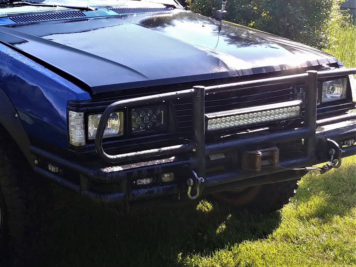

Marc556 Posted May 23, 2020 Share Posted May 23, 2020 Hey Guys, I want to install the lights shown on the picture on my Gen Brat. Here, in Europe, it seems impossible to find in Europe? do you know where I can order this kit in US ? Thank you Quote Link to comment Share on other sites More sharing options...

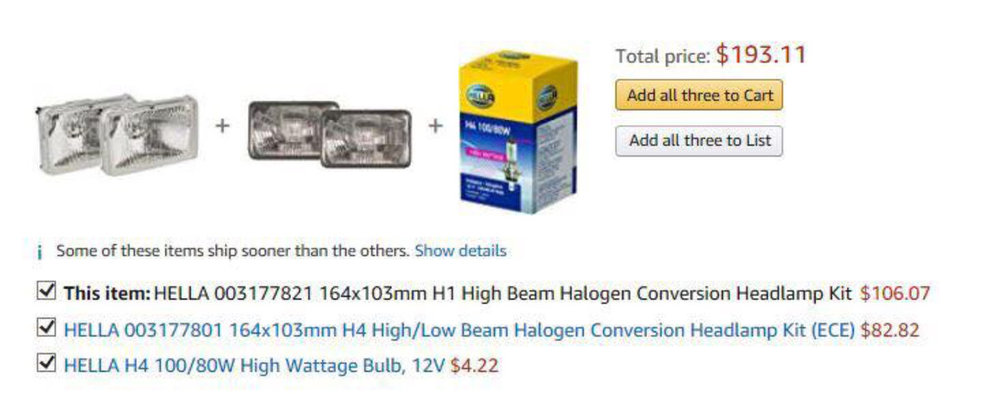

aba4430 Posted May 23, 2020 Share Posted May 23, 2020 I bought my kits from Amazon. Check out amazon.com. If you are getting the Hella kits, the H1 (High Beam) and H4 (Low Beam) bulbs are included in the kits. Quote Link to comment Share on other sites More sharing options...
Marc556 Posted May 23, 2020 Author Share Posted May 23, 2020 Low Beam kit is not available with shipment in Luxemburg. Quote Link to comment Share on other sites More sharing options...
aba4430 Posted May 23, 2020 Share Posted May 23, 2020 Get two of these and buy H4 bulbs of your choice. The Hi/Lo kit is not being sold by Amazon presently, hence the problem. Individual Lo/Hi headlamp Quote Link to comment Share on other sites More sharing options...

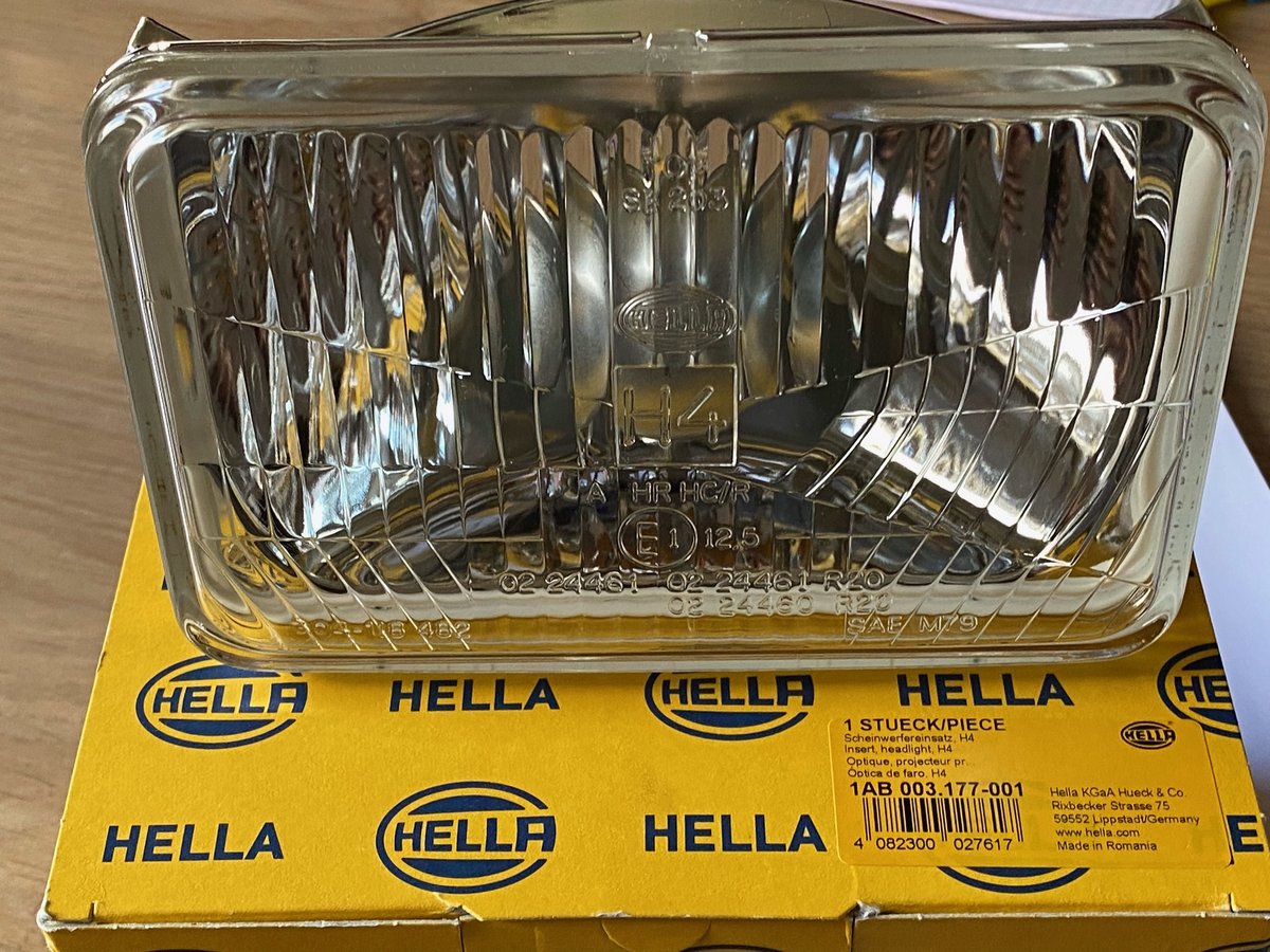

Marc556 Posted June 6, 2020 Author Share Posted June 6, 2020 Hi Guys, I ordered Hella 003177801 and I received 003177001... I try to find on internet if there are equivalent, but nothing is clear. Could you help me? Quote Link to comment Share on other sites More sharing options...
GeneralDisorder Posted June 6, 2020 Share Posted June 6, 2020 Why don't you check the plug and try installing it? Hella is based in Germany and are not common sealed beams here in the US. Not likely anyone on this forum has any clue. GD Quote Link to comment Share on other sites More sharing options...
Marc556 Posted June 6, 2020 Author Share Posted June 6, 2020 (edited) Yes you are right.... I shall check ASAP.. The car is not at home, so I have to wait. But if I can receive the information here, I can give them immediately back to the supplier. Edited June 6, 2020 by Marc556 Quote Link to comment Share on other sites More sharing options...
aba4430 Posted June 6, 2020 Share Posted June 6, 2020 You received the single low/Hi beams with the H4 bulbs. The part number for the kit with two lamps etc. is 003177801. The lamp assemblies with P/N's 003177801 and 003177001are equivalent. Quote Link to comment Share on other sites More sharing options...
