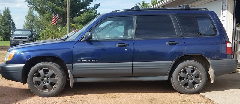

heartless Posted May 25, 2020 Share Posted May 25, 2020 i have a 2002 Forester with the EJ251 that is just about to hit 260K - headgaskets were done long before I got it, supposedly around 85K mark.. runs and drives great, no major issues at all the other half has a 2006 LL Bean outback with the 3.0 - he has more issues with his than I do with mine.. fussy sensors and such, lol, but he is slowly catching up on the mileage, well over 225K at this point. Link to comment Share on other sites More sharing options...

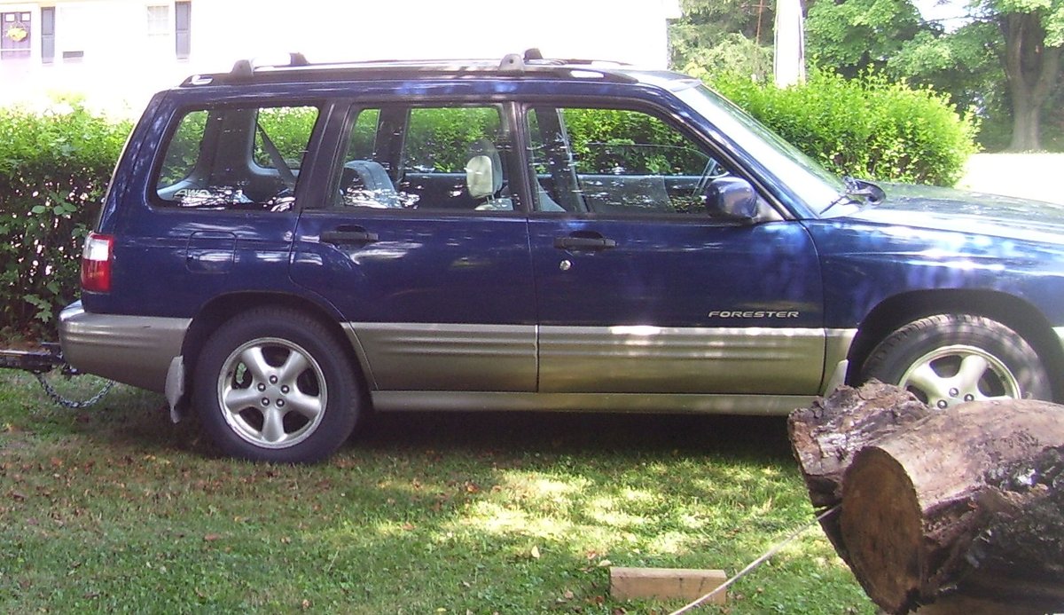

Stelcom66 Posted May 26, 2020 Author Share Posted May 26, 2020 Wow, 260K, and blue 2002 - now I'm really wishing I kept this! It's a 2002S 5MT. The air conditioning was shot, quoted around $1300 to repair. It was around 130k miles, (cool you and your partner have well over 200k) so I was thinking it was going to need head gaskets soon. Traded it in 3 years ago. Interesting the newer 3.0 has more issues. I miss my Forester. Link to comment Share on other sites More sharing options...
heartless Posted May 26, 2020 Share Posted May 26, 2020 eh, the 3.0 isn't that bad.. mostly just random codes that come & go all by themselves - like i said, fussy sensors... but yeah, stuff is a little more expensive for it, too mine is the auto version, but yeah, same blue.. Link to comment Share on other sites More sharing options...
Stelcom66 Posted May 26, 2020 Author Share Posted May 26, 2020 Nice! Looks to be in really good shape. A similar scene to here, I also have a flag outside and an old pickup truck! Some berate the 4EAT, but many times at the same time saying it's very reliable, which is true. As long as the 'go' follows 'comes' with the 3.0 codes that's fine. Very few headgasket failure reports with those and a timing chain. As I have more time these days I've been doing a lot of research. I tend to focus on 10+ year old vehicles. Looking for reliability another I considered was a Toyota 4Runner. Overall excellent consumer reviews - but a good place to look are the brand's forums. The Toyota 4.0 V6 is prone to head gasket failures. There's a whole thread there about that, like on the subaroutback.org forum. Likely a very small percentage, but of course a red flag. Re: the spun bearing issue on the Subaru 2.5 engines, again the occurrences are likely rare - but one of my sons had a 2007 Legacy and I think that's what happened to it. 260k is one of the highest mileages I've heard of on an EJ25. Good to know it's possible. Link to comment Share on other sites More sharing options...
