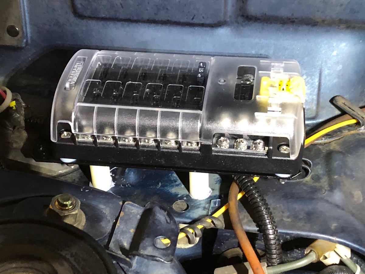

aba4430 Posted June 10, 2020 Share Posted June 10, 2020 I relocated my alarm siren from the right side shelf (right of spare tire) to the left front fender area, and installed a 12 position fuse block in the area. Used a galvanized lumbar tie plate from HD, coated it up a bit with primer and black color and mounted it on 4X 1" Nylon spacers. The fuse block is mounted on this plate using 1/4" Nylon spacers and M4 SS hardware. Now, the slow process of cleaning up the accessory wiring begins. Quote Link to comment Share on other sites More sharing options...
