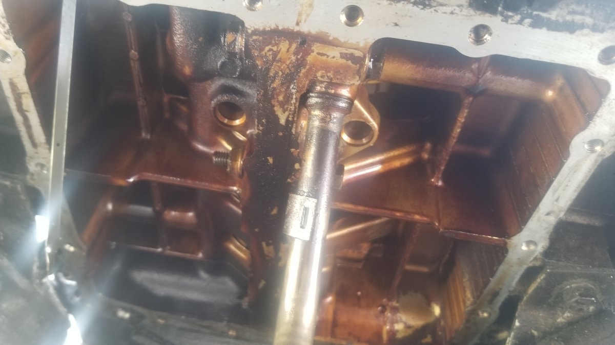

Ionstorm66 Posted June 12, 2020 Author Share Posted June 12, 2020 25 minutes ago, GeneralDisorder said: Why? The EA filters are already huge compared to most modern engines. These engines aren't particularly hard on oil or overly powerful for their size and don't really benefit from synthetics. The oil control rings are wide and not prone to coking even with $hit oil from walmart. I don't see the advantage. GD This car had a hard/poorly maintained life before me. This is the inside of the engine after about 5 2K mile oil changes with a few atf flushes. When I first got it, it was worst. I did both the valve cover gaskets, and there was amount 1/16-1/8" of sluge. Link to comment Share on other sites More sharing options...
