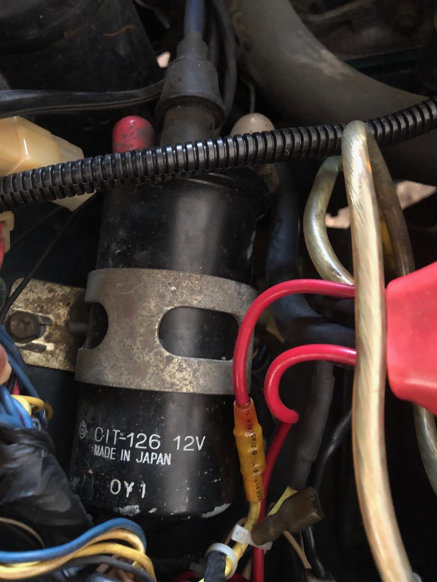

aba4430 Posted June 17, 2020 Share Posted June 17, 2020 (edited) You have asked for Hitachi P/N's for 80 to 84's. I can tell you that the manual transmission 85 to 88 2 door hatches and Brats used Hitachi distributor P/N 429878900; autos used 429879100. The coil P/N's are 429887810 for manual transmissions and 429887310 for manual and autos. So I think either coil can be used for the manual's. Note, I have been running a Hitachi CIT-32 (I will check the number again) coil on my 87 Brat since 2012 with no issues. Not sure if these 85 to 88 P/N's are helpful. Separately, AZ has several options for coils, including a couple of NGK's: Ignition Coil Options at AZ Correction to the Hitachi coil P/N I have been using since 2012. I stated above it was CIT-32. It is actually CIT-126. Edited June 22, 2020 by aba4430 Correction of a P/N. 1 Link to comment Share on other sites More sharing options...

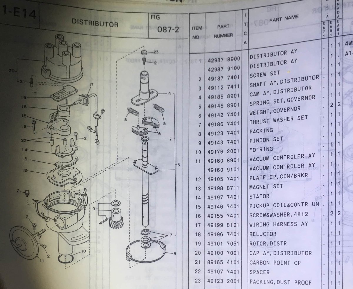

mkoch Posted June 19, 2020 Share Posted June 19, 2020 (edited) This is from my 1984 parts manual. What does the module look like? Edited June 19, 2020 by mkoch 1 Link to comment Share on other sites More sharing options...

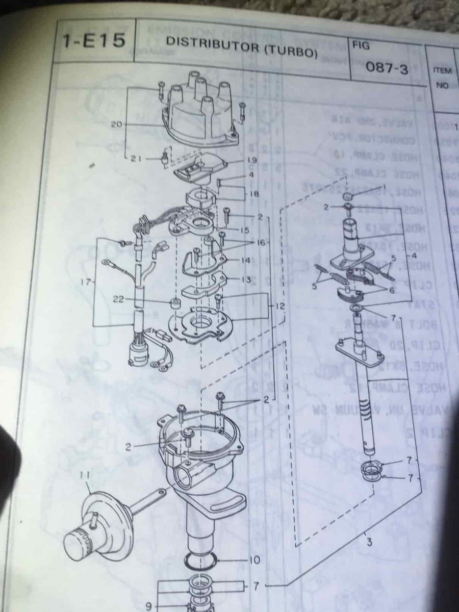

mkoch Posted June 19, 2020 Share Posted June 19, 2020 2 Link to comment Share on other sites More sharing options...

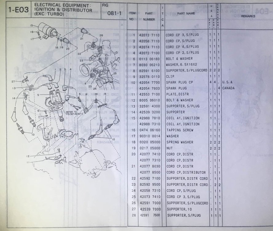

Dwayne Oxford Posted June 19, 2020 Author Share Posted June 19, 2020 On 6/17/2020 at 12:43 PM, aba4430 said: You have asked for Hitachi P/N's for 80 to 84's. I can tell you that the manual transmission 85 to 88 2 door hatches and Brats used Hitachi distributor P/N 429878900; autos used 429879100. The coil P/N's are 429887810 for manual transmissions and 429887310 for manual and autos. So I think either coil can be used for the manual's. Note, I have been running a Hitachi CIT-32 (I will check the number again) coil on my 87 Brat since 2012 with no issues. Not sure if these 85 to 88 P/N's are helpful. Separately, AZ has several options for coils, including a couple of NGK's: Ignition Coil Options at AZ Expand Thanx! My '82 FSM specifies the CIT-79 coil for Hitachi. Now to figger out which PN is which? Link to comment Share on other sites More sharing options...
Dwayne Oxford Posted June 19, 2020 Author Share Posted June 19, 2020 On 6/19/2020 at 3:46 AM, mkoch said: Expand THANX!! THINK I got it figgerd out. The 42988-7310 is the Hitachi coil, Hitachi CIT-79 in '82 FSM. NEEDS external resistor. MAYBE now I can quit killing the module. 1 Link to comment Share on other sites More sharing options...
Dwayne Oxford Posted June 19, 2020 Author Share Posted June 19, 2020 On 6/19/2020 at 3:37 AM, mkoch said: Expand THANX!! The bottom pic is Hitachi. Link to comment Share on other sites More sharing options...

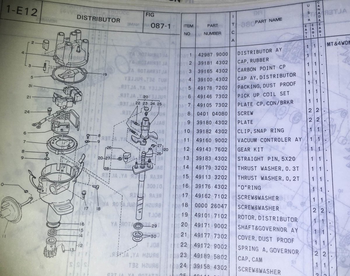

Step-a-toe Posted June 20, 2020 Share Posted June 20, 2020 On 6/19/2020 at 3:32 AM, mkoch said: This is from my 1984 parts manual. What does the module look like? Expand We did not see these twin cover Denso on EA81 in Australia 1 Link to comment Share on other sites More sharing options...
Dwayne Oxford Posted June 21, 2020 Author Share Posted June 21, 2020 On 6/19/2020 at 3:37 AM, mkoch said: Expand THANX!! The bottom pic is Hitachi. Link to comment Share on other sites More sharing options...
