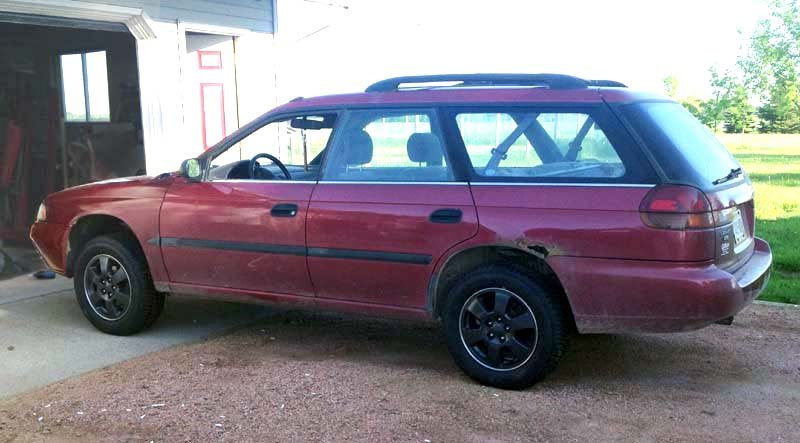

SubieShop Posted June 26, 2020 Share Posted June 26, 2020 I've got a 1996 Subaru Legacy L Wagon. Recently put a Frankenmotor (original 2.2 heads with 2.5d block) in it and need a few inches of lift to clear the all terrain tires I'm wanting to put on. I've pretty much decided to try the same year outback strut/spring combo to get another inch or two. What brand/website or parts store have people been happy with as far as replacement suspension components go? I prefer to buy the whole preassembled strut/sprint combo is possible but I'll make do with what I can find. I appreciate any tips or experience you guys can share! Quote Link to comment Share on other sites More sharing options...
