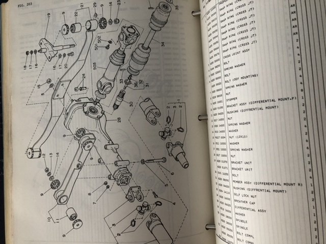

Jonv23 Posted July 2, 2020 Author Share Posted July 2, 2020 Thanks! I am talking about the flat discs above and below the ends of the mustache bar. Link to comment Share on other sites More sharing options...

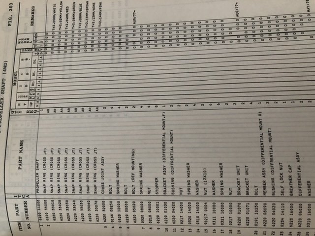

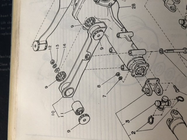

moosens Posted July 2, 2020 Share Posted July 2, 2020 (edited) Inside those flat disks with their crowns are the sleeved bushings. Need 4 of those bushings for mustache bar and lateral bracket. Note the same crowned disks are on the ends of the diff. mount bracket. So you will need 8 of those to do a complete job. 8 disks 4 bushings original p/n for “stopper” aka the crowned disk is 6220 10001 and the bushings p/n 6220 04020 Maybe be worth hunting. I know most likely they’re going to be out but you never know. I see you’re up north. Back when my local was way past keeping that old stock I would have them use a west coast or other regional distributor and often I would score. Edited July 2, 2020 by moosens Link to comment Share on other sites More sharing options...
moosens Posted July 2, 2020 Share Posted July 2, 2020 Going forward I’d be concerned with the bracket unit which handles this whole bar and diff. Put a good eye to those as you have the unit down. Link to comment Share on other sites More sharing options...

moosens Posted July 2, 2020 Share Posted July 2, 2020 (edited) This is the one (both sides) to check. Edited September 21, 2021 by moosens Media trim Link to comment Share on other sites More sharing options...
