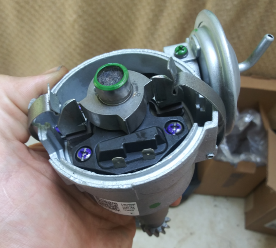

The project is going great. It's taken some time and money but we did get the correct distributor by using an 85 GL as our hypothetical vehicle.
Neither the distributor nor the cap came with a pigtail/wiring harness to go from the distributor to the coil.
There are two terminals side by side inside the distributor where a plug should attach.
I've built a plug and pigtail out of wire and silicon but I need to know which of the two terminals is positive.
The one closer to the front or rear of the vehicle?
Thanks again in advance!
Rather than describe position in relation to vehicle,
Maybe add a photo of the module and peeps can suggest which terminal in pic goes where.
In EA models there tends to be yellow wires and black wires to the coil.
I only had one EA82 dizzy with that 2 pin module that I borrowed to get a stranded EA81 running urgently so can't help
