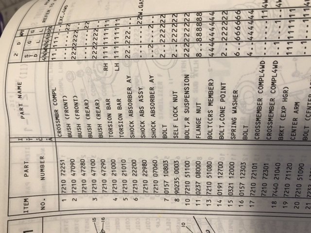

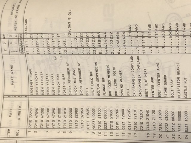

Thanks guys, but as I mentioned it’s not the moustache bar bushes I’m looking for. It’s the mounting bushes for the main beam itself, the one that the torsion bars are inside, where it mounts to the body.
Oddly, they don’t seem to be in any drawing I’ve seen.
Pardon my lack of rotation on those. Can’t see how but anyways those are form a Brat-MPV supplement for factory parts manuals.
Let me know if I failed and I’ll see what else there is for you.

My first glance at diagram looked like the bush is #11 but #11 is a bolt.....
