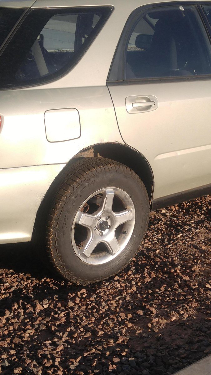

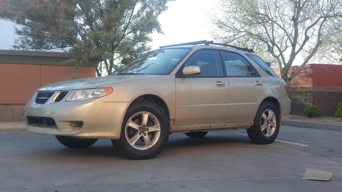

Have a 05 Saab 9-2x Linear, powered by a TIRED EJ253, non turbo SOHC, and a worn out 5sp manual (211k miles on all original powertrain). Bought it lifted on stock tires, previous owner told me it was on forester shocks, no clue what springs or anything. Tires are 215/70/16 and fit with the skirts removed and some mild frame-bashing on the rear. I'd like to move the rear tires rearward if I make custom control arms for it. Don't have a more recent pic than the first but I have the front and rear fenders fully chopped, like you can see in the second pic (I have since welded the rear quarters back together). Oh yeah and it was once a Vermont car so it's decently rusty and was pretty beat up so I don't feel too bad about chopping up a "rare" car

What you need is to drop the rear swing arm mount the same amount as your strut lift has. This will put the wheel back in more of a central position.

Thanks! I guess I forget it kinda moves fore and aft with travel.
