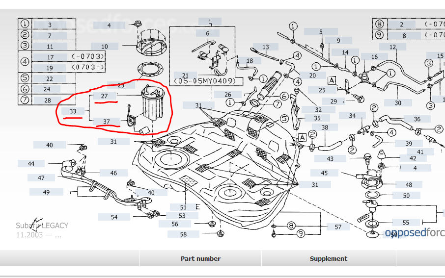

So it appears on the 08 OB the fuel pump is integrated with the sending unit??
If that is the case, under the circumstances,  is the pump is still operative(?) just a failing sensor?

what do you mean by "integrated"?
the pump and gauge sending unit have been a part of a single assembly for a long time... 27 is the fuel pump, 37 is the sending unit... together they are an assembly - #33...
Yes the pump will run, it is a different circuit.

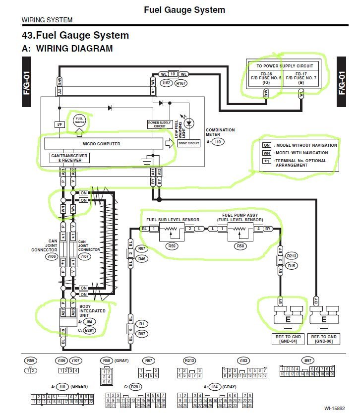

There are two sending units. One on each side of the fuel tank. The FSM says to check both and the gauge and replace. You would have to remove them to check them. It does not mention the Body Integrated Unit shown in the diagram.
The diagram shows a micro computer feeding the Fuel Gauge. I don't know if it is part of the gauge or the combination meter.
