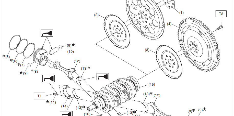

DoubleBogey Posted August 9, 2020 Author Share Posted August 9, 2020 (edited) Update: It's not the crankshaft position sensor. I replaced it and still the same. I must say getting to it is a pain and it decided to separate and leave a bit in the hole. Took some work but got it replaced. Also no codes which is typically a good thing but it would be nice to have a lead here. I'm pretty much down to I have the flywheel or maybe the ring for the crank position sensor plate clocked wrong . I'm going to do some more investigation before I drop the transmission again. This maybe one of those mistakes you only do once because of the amount of work it is to fix a simple problem. Picture is page 7 in the attached file. 1 General Description.pdf Edited August 9, 2020 by DoubleBogey Link to comment Share on other sites More sharing options...

DoubleBogey Posted August 23, 2020 Author Share Posted August 23, 2020 Ok guys. I wanted tomake a final resolution post and help some poor fella down the road. I was correct that the crank shaft position sensor disk was clocked. My lack of attention to detail won me the prize of starting over and repulling the transmission. Once the hole in the disk was matched with the pin and re assembled the computer sent spark. Still confused as to why I didn't get a code for messed up timing. Anyway thank you all for taking the time to help out. And I hope this thread will help someone in the future. Link to comment Share on other sites More sharing options...
