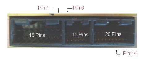

Rampage Posted August 12, 2020 Share Posted August 12, 2020 Good. 12 volts on that fuse indicates the power out of the ign. switch is good. I didn't want you to change the TCU and find out later you need a switch. If you want to check the pins at the TCU, these are the 3 to check for power. The wire color on Pins 1 and 6 is Yellow. Goes hot with ign. ON. Pin 14 is Yellow - Red stripe. Always hot. The image would be looking at the wires on the connectors plugged in. Notice the release tabs at the top of each one. Pin 1 is in the upper right corner of each one. Quote Link to comment Share on other sites More sharing options...
