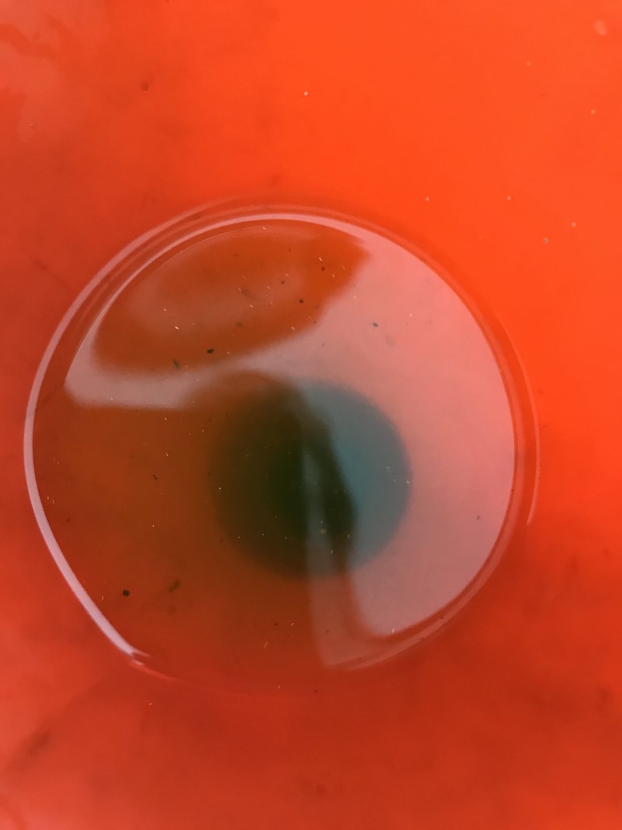

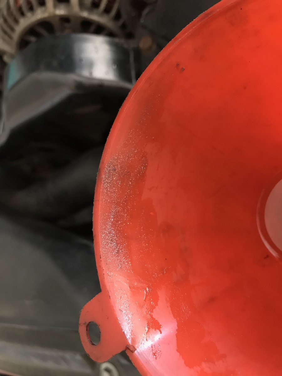

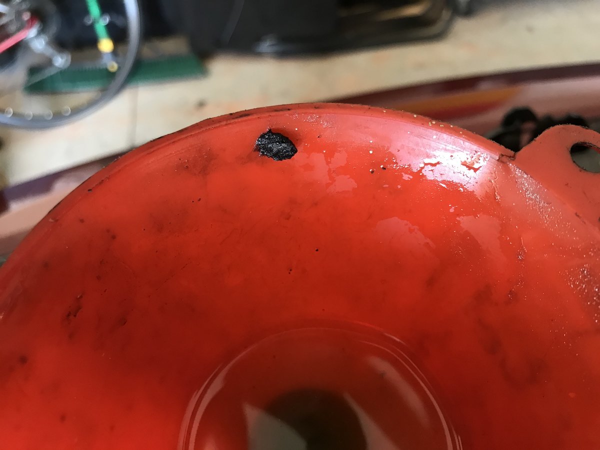

tylertrend Posted August 10, 2020 Share Posted August 10, 2020 Interesting observation as I was out doing another bleeding of the system. There are a lot of small chunks that look like graphite and are very soft. I was able to get a couple large ones and smear them on the funnel and they are full of a brass looking flake, I can see it pooling on the bottom of the filler neck too. Maybe old deposits from a HG problem years back? I never did a complete "flush" of the system when I did them. Maybe the rad is plugged up with this stuff. Curious about where all that metallic flake is coming from. Link to comment Share on other sites More sharing options...
idosubaru Posted August 10, 2020 Share Posted August 10, 2020 (edited) 1 hour ago, tylertrend said: Interesting observation as I was out doing another bleeding of the system. There are a lot of small chunks that look like graphite and are very soft. I was able to get a couple large ones and smear them on the funnel and they are full of a brass looking flake, I can see it pooling on the bottom of the filler neck too. Maybe old deposits from a HG problem years back? I never did a complete "flush" of the system when I did them. Maybe the rad is plugged up with this stuff. Curious about where all that metallic flake is coming from. That doesn’t seem like great news, If it’s really bad it’s worth noting. How did the gaskets fail the first time - what all symptoms presented ? Keep in mind it’s a 16 year old overflow bottle with normal old age ambient grime on the inner walls that’s never (or once maybe) been cleaned and is now exchanging overheating coolant with the radiator daily. I would be careful to assume too much unless it’s egregious or I can see and diagnosis the car history and amount in person. Edited August 10, 2020 by idosubaru Link to comment Share on other sites More sharing options...
tylertrend Posted August 10, 2020 Share Posted August 10, 2020 8 minutes ago, idosubaru said: That doesn’t seem like great news, If it’s really bad it’s worth noting. How did the gaskets fail the first time - what all symptoms presented ? Keep in mind it’s a 16 year old overflow bottle with normal old age ambient grime on the inner walls that’s never (or once maybe) been cleaned and is now exchanging overheating coolant with the radiator daily. I would be careful to assume too much unless it’s egregious or I can see and diagnosis the car history and amount in person. Original HG failure was just oil leaks, Didn't run hot for me or the PO to my knowledge. I had the overflow out a few weeks ago and gave it a good scrubbing. It's this metallic flake stuff that's weird to me. I've been reading about issues with heater core blockages causing issues but this car has always, and does today, have great heat. No exceptions. The hot running didn't really start until I moved from ME to OK so maybe it just needs a good flushing and a new rad. Link to comment Share on other sites More sharing options...

nvu Posted August 11, 2020 Share Posted August 11, 2020 22 hours ago, tylertrend said: Interesting observation as I was out doing another bleeding of the system. There are a lot of small chunks that look like graphite and are very soft. I was able to get a couple large ones and smear them on the funnel and they are full of a brass looking flake, I can see it pooling on the bottom of the filler neck too. Maybe old deposits from a HG problem years back? I never did a complete "flush" of the system when I did them. Maybe the rad is plugged up with this stuff. Curious about where all that metallic flake is coming from. Those brass flakes reminds me of oldschool bars stop leak powder. Link to comment Share on other sites More sharing options...
tylertrend Posted August 11, 2020 Share Posted August 11, 2020 6 hours ago, nvu said: Those brass flakes reminds me of oldschool bars stop leak powder. It could well be from the PO. I find out something new every day it seems! Link to comment Share on other sites More sharing options...
el_freddo Posted August 11, 2020 Share Posted August 11, 2020 13 minutes ago, tylertrend said: It could well be from the PO. I find out something new every day it seems! That stuff is known to block up radiators! Cheers Bennie Link to comment Share on other sites More sharing options...
