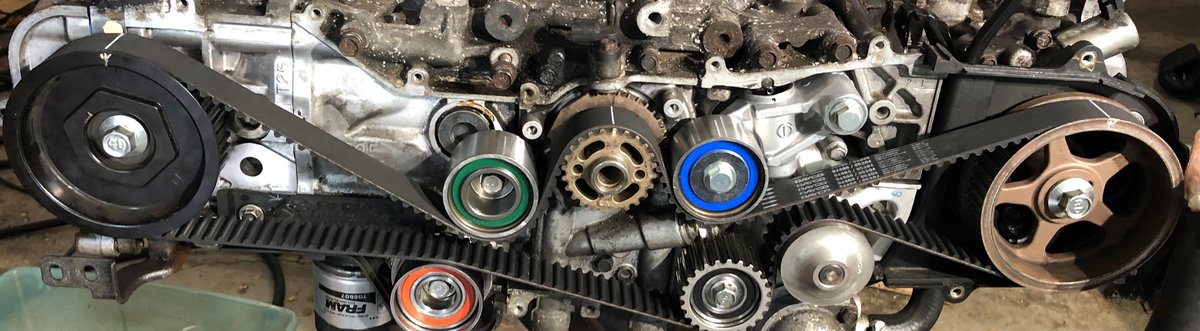

el_freddo Posted September 14, 2020 Share Posted September 14, 2020 On 9/14/2020 at 12:14 AM, Monacle-Pete said: I used TDC to make sure I had cylinder 1. I put the timing marks in the correct positions and then put the timing belt on. Expand ??? Thats old school thinking with a distributor. TDC doesn’t matter with the cam belt fitment. In fact, the pistons are halfway down the cylinders when the crank timing mark is set properly. This ensures the timing belt is installed correctly in terms of crank position If you use any other mark to align the crank you’ve got it wrong. And if you’re using the arrow on the cam wheel that’s wrong too. You need to use the small line on the rim of the cam wheel on either side. One side will be free of valve spring tension, the other side will be held by/have spring tension acting on it. All the beat with it, I’m sure your issue is that the Cam belt timing/alignment isn’t correct. Cheers Bennie Link to comment Share on other sites More sharing options...
Monacle-Pete Posted September 14, 2020 Share Posted September 14, 2020 Hi Bennie, Thanks for the information. I feel it is a timing issue also but I've followed the steps in the manual while setting the cams and crankshaft before putting the timing belt on (see attached picture). The metal cam gear (driver side) is under tension and the plastic cam gear (passenger side) is not. Paul 1 Link to comment Share on other sites More sharing options...

el_freddo Posted September 15, 2020 Share Posted September 15, 2020 On 9/14/2020 at 12:47 PM, Monacle-Pete said: Hi Bennie, Thanks for the information. I feel it is a timing issue also but I've followed the steps in the manual while setting the cams and crankshaft before putting the timing belt on (see attached picture). The metal cam gear (driver side) is under tension and the plastic cam gear (passenger side) is not. Paul Expand That alignment looks bang on Paul. Ive not heard of cam or crank sensors going bad. They’re just coiled copper wire wrapped around a magnet, they’re sealed pretty tight and there really isn’t much to go wrong with them (they also make good cruise control speed sensors for after market units!). Are the cam and crank sensors plugged in correctly/fully? I like NVU’s suggestion of the super junction plug pins. Although I’ve not heard of this being an issue it could be worth the 10-15 minutes to rule them out. Any codes from the ECU to share? Cheers Bennie Link to comment Share on other sites More sharing options...
Monacle-Pete Posted September 18, 2020 Share Posted September 18, 2020 Thank you all for your replies and suggestions. Well this turned out to be kinda strange. The problem is solved. I used the diagram in a Chilton manual for cylinder to coil connections, however, that diagram is wrong. Bennie, thank you! You set me on the path to check and recheck everything and that is how I came across the problem with the plug wires going to the wrong connections on the coil. Once I connected them properly it started right up! Thanks again! I appreciate all the help and suggestions! 1 Link to comment Share on other sites More sharing options...
