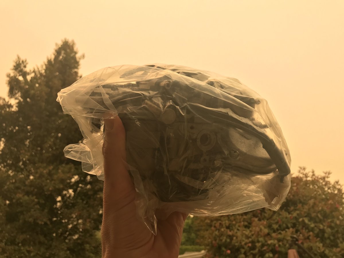

NuclearDeLorean Posted August 21, 2020 Author Share Posted August 21, 2020 My new carb also arrived! “Why did you need a new carb? Why didn’t you rebuild? Do you know what you’re doing?“ ...well, I needed a new one because the PO and two separate carb shops tried to remove an accelerator pump that’s fused to the carb. No one could remove it, and I found a completely rebuilt one for a great deal, so why not! It bogs bad when you give it any gas but is tuned a bit rich so it’ll run past idle, Didn’t rebuild because of previous answer, and I do not know what I am doing. If I can learn the Bosch K-Jetronic Fuel injection system (installed in 380sl Mercedes, 308 Ferrari’s, and DeLoreans) I can learn this fuel system. I will learn this fuel system. Carbs are like transmissions to me, mysterious and magical. I will learn this fuel system, all check balls, floater thingies, and venturi’s combined! would have installed today but there was literal burning debris falling from the sky, probably not the best to fall into the intake. Another day, hopefully soon! Link to comment Share on other sites More sharing options...
NuclearDeLorean Posted August 26, 2020 Author Share Posted August 26, 2020 New carb is installed, moved a bracket for the ...choke? , fuel inlet, and the air cleaner center threaded rod and it fired right up! ...after I put fuel into the carb. Do you always need to put fuel into a new carb when you first start it? I cranked it 3 separate times, pulled the fuel line and put it into a jar, and no fuel while cranking. I actually thought I had a bad fuel pump all of a sudden. Change a tire and your headlights don’t work. I was stumped. Then put fuel down the carb and it fired and ran! Does the fuel pump only run when the engine is running? Not when cranking? I didn’t see any fuel while cranking the engine over. Now onto the compression test to see if I have a head gasket issue. But as for now, I’ve got about 2 miles on the car and it runs AWESOME. Awesome!!!!!!! Link to comment Share on other sites More sharing options...

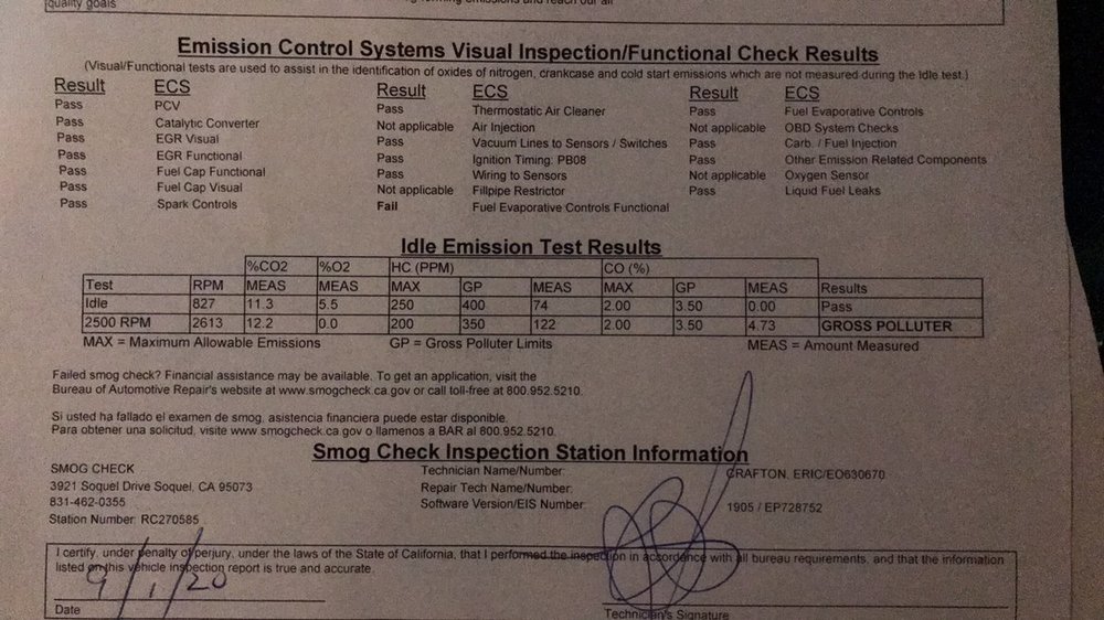

NuclearDeLorean Posted September 3, 2020 Author Share Posted September 3, 2020 (edited) Well my evap system is leaking so I’ve got a smoke test Tuesday. The carb is now tuned but I didn’t have it tuned when I went to get it tested. DUR! I found the idle screw dead center above the gasket. Turned it in until it bottomed out (gently) then backed out 2.5 turns. I then started the car, warmed, dropped idle to around 750-800 using throttle linkage screw, and backed the mixture screw out until I reached the highest idle. Then screwed if back in right before the idle starts dropping. I then dropped the throttle back to 750-800 with throttle linkage screw. These are my smog results BEFORE carb tuning and with the leaking evap system. Anyone know if since I “tuned” my carb using the above method if that is A) correct and B ) going to help my 2500 CO pass? Edited September 3, 2020 by NuclearDeLorean Link to comment Share on other sites More sharing options...
NuclearDeLorean Posted September 3, 2020 Author Share Posted September 3, 2020 My choke is not getting 12v so my choke is totally closed at warm temp. I need to find why I do not have 12v at the choke. Link to comment Share on other sites More sharing options...
NuclearDeLorean Posted September 6, 2020 Author Share Posted September 6, 2020 I now have 12V to my choke. The fuse behind the glove box was blown. I have a new carb so maybe something happened back in the day.. The choke is now fully open when the engine is warm. Should drop my CO and help me pass my 2500 smog check! Woo! Link to comment Share on other sites More sharing options...
