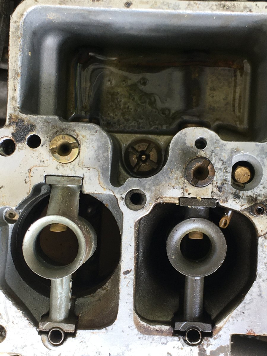

87GL606 Posted September 13, 2020 Author Share Posted September 13, 2020 Okay so I’ve got the top of the carb off no easy task compared to a holly. Float seems fine. The bowl was full with what seems like new gas although the floor of the bowl was covered in green sludge. I want to finish taking the carb out I’m assuming I’ll have to remove this screw(picture attached)? Link to comment Share on other sites More sharing options...
DaveT Posted September 13, 2020 Share Posted September 13, 2020 Gunk in the bowl, figure it's in the jets, idle passages, accelerator pump, emulsion tubes, all of it. Link to comment Share on other sites More sharing options...
el_freddo Posted September 14, 2020 Share Posted September 14, 2020 To remove carb unbolt the four 10mm nuts at the base of the carb. If you’re going to strip the carb down, it’s a good time to crack that screw from its hold while the carb is still fitted to the engine. Cheers Bennie Link to comment Share on other sites More sharing options...
