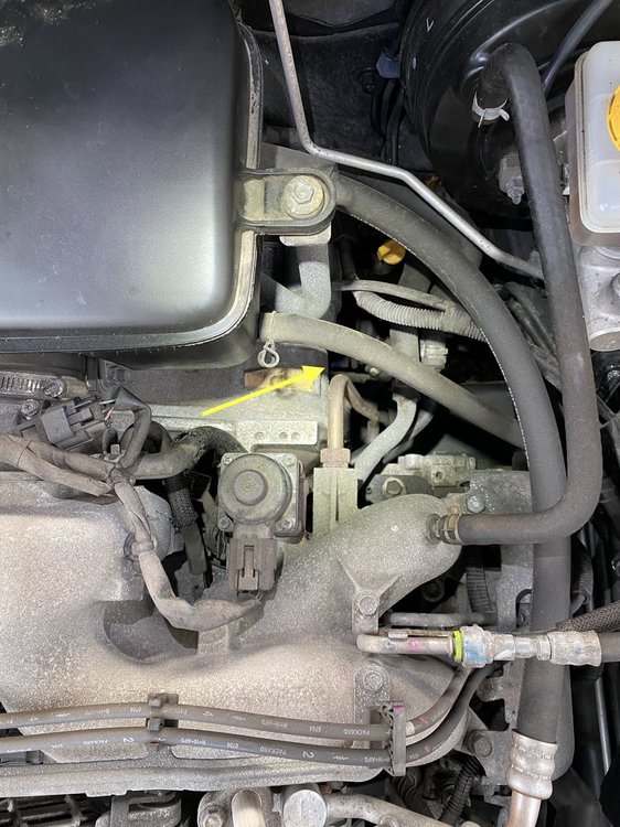

bluevelvet77 Posted September 17, 2020 Author Share Posted September 17, 2020 another picture... Link to comment Share on other sites More sharing options...
GeneralDisorder Posted September 17, 2020 Share Posted September 17, 2020 The overflow reservoir does not get filled. It should be about 1/3 to 1/2 depending on system pressure. Head gaskets on that model leak oil, not coolant. It's really not a matter of if, but when they start leaking. Had you done your research before buying you would know that. The dealership is THE WORST place you can have the gaskets done. You can expect them to leak again in 20-30k. They use the wrong gasket and insufficient cleaning / surface prep. You are likely stuck with it, unless you are able to return it, or pay a proper Subaru specialist to do it right with the turbo model gaskets. GD 1 1 Link to comment Share on other sites More sharing options...

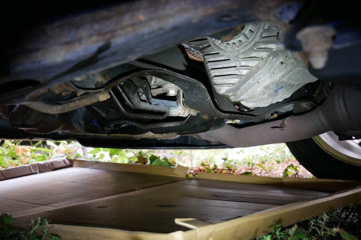

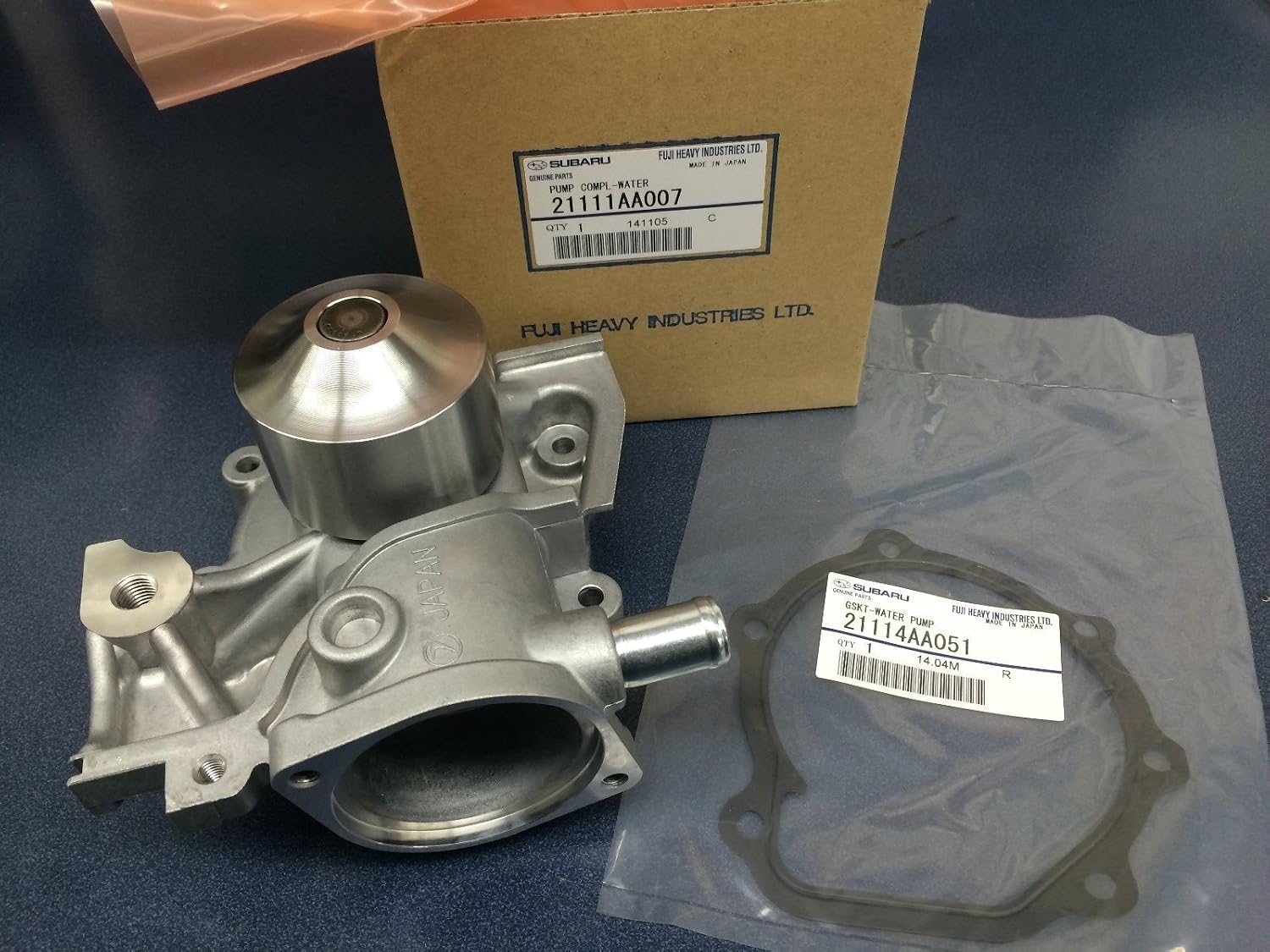

bluevelvet77 Posted September 17, 2020 Author Share Posted September 17, 2020 This is definitely a coolant leak .. can't really tell from this picture but it was green. So maybe he's right after all, it is the water pump. I'm just having difficulty having a proper labeled diagram of the engine online. Link to comment Share on other sites More sharing options...

Mike104 Posted September 18, 2020 Share Posted September 18, 2020 (edited) On the EJ25 engine the water pump is above where the thermostat housing is. The lower radiator hose is attached to the water pump. The water pump is driven by the timing belt. It's located on the front of the engine behind the timing belt cover. The problem with leaks on the Subaru is that they often get blown back onto the engine and can collect and then drip off somewhere unrelated. Getting a knowledgeable independent Subaru specialist is a good idea to evaluate it. Edited September 18, 2020 by Mike104 Link to comment Share on other sites More sharing options...
bluevelvet77 Posted September 18, 2020 Author Share Posted September 18, 2020 (edited) 1 hour ago, Mike104 said: 2 Thank you!! That part about them getting blown back onto other parts of the engine is useful. It hasn't (yet) exhibited the symptoms of a head gasket leak so perhaps this mechanic is right. My strategy is to let them replace the water pump for free and see if that works. While at the same time, trying to drive it as little as possible. Edited September 18, 2020 by bluevelvet77 Link to comment Share on other sites More sharing options...

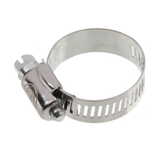

bluevelvet77 Posted October 3, 2020 Author Share Posted October 3, 2020 Thanks everybody. I had it taken in and the clanking turned out to be a rusted exhaust shield. Apparently, it is coming apart and they are suggesting I replace it at some point (OEM part is 200+ dollars) The sound has died down a bit over time and I guess I can deal with it (for now). Found no leaks so I'm guessing it was just residual from the work they did on it? I can confirm because the last time I laid cardboard out... nothing. Only thing that's been nagging at me... When I'm on the highway for awhile (20-30 minutes) and I slow down once I get into town.. almost feel like there is a misfire/loss of power/stutter when I let off the gas, and gently press it back in. Hiccups twice. Could that just be an awkward gear change? I mean to try this with the sport shift and see if it's still there. It isn't evident anywhere or any other time in the drive. It's only got me paranoid because I had a similar problem with my VW at the end of it's life. Link to comment Share on other sites More sharing options...

brus brother Posted October 3, 2020 Share Posted October 3, 2020 generally you can use large stainless hose clamps to tighten the heat shields. bang around and see where the shield has come loose and add a clamp. Link to comment Share on other sites More sharing options...
