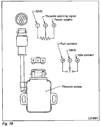

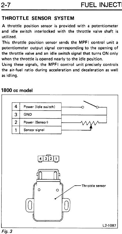

Rampage Posted September 27, 2020 Share Posted September 27, 2020 Make sure the Idle switch is working on the TPS. 1 Link to comment Share on other sites More sharing options...

Step-a-toe Posted September 27, 2020 Share Posted September 27, 2020 And while you are looking at TPS take note if the wiring just 30? mm from TPS has a three wire, possibly round, take off plug at all, something plugged in or not AND how many wires to TPS itself I have had three combinations I think. Also think yours may be the 86 wiring, ECU etc flapper AFM likely it is TPSwitch not TPSensor as listed in diagram above Link to comment Share on other sites More sharing options...

Step-a-toe Posted September 27, 2020 Share Posted September 27, 2020 Just thinking of Rampages suggestion... this thing stalls being shifted into D or R I think, this normally without any foot on accelerator, so throttle position do dad be doing bought but sit at idle Link to comment Share on other sites More sharing options...
Rampage Posted September 27, 2020 Share Posted September 27, 2020 The previous image is from the 88XT manual. One connector. The following image is from the EA82 manual. Two connectors one round and one flat. Link to comment Share on other sites More sharing options...
