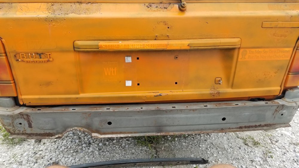

So I pulled the rear bumper off my parts car to plan out a custom rear bumper. With all the plastic and foam off it's not actually too bad of a design. You could just weld a plate on the rear and top and have a pretty nice steel bumper.16016600549421750185363155097790.thumb.jpg.6330e4e4f7a4d3831b09839a04a9bc8f.jpg
The weak point seems to be the mounting tabs. Both of my spare bumpers have one tap tweaked. Probably not a bad weak point to have as it saves the body. Plus you can flip them over and use a jack to untweak it.
