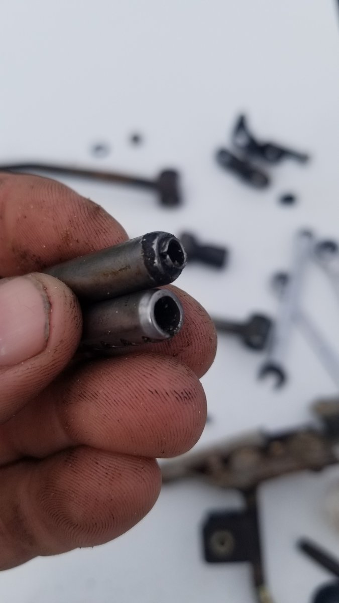

Ionstorm66 Posted October 3, 2020 Author Share Posted October 3, 2020 So got the one off my car. Figured out why it was so hard. So my car had a roll pin a roll pin. It has the a 12mm head shouldered bolt with no bushing. The 86 donor had a single roll pin. It has a 9/16 head grade 8 bolt and a steel bushing. Obviously the standard bolt and steel bushing was someones fix. Is the double pin normal? Quote Link to comment Share on other sites More sharing options...
GeneralDisorder Posted October 3, 2020 Share Posted October 3, 2020 They are supposed to have a double roll pin. I generally knock them out together. GD 1 Quote Link to comment Share on other sites More sharing options...
Ionstorm66 Posted October 3, 2020 Author Share Posted October 3, 2020 4 hours ago, GeneralDisorder said: They are supposed to have a double roll pin. I generally knock them out together. GD I ended up putting both. Also I found that with the stock yoke bolt, a section of 3/8 ID vinyl hose with 3/8 flat washers on both sides of the yoke, fit perfectly. I can now tell what gear I'm in by looking at the shifter! Quote Link to comment Share on other sites More sharing options...
