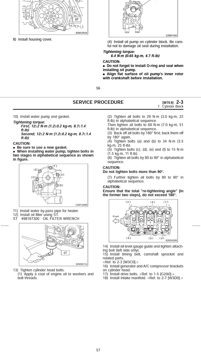

nicksubaru Posted October 24, 2020 Author Share Posted October 24, 2020 For the heads, this is how everyone does it? Quote Link to comment Share on other sites More sharing options...
el_freddo Posted October 24, 2020 Share Posted October 24, 2020 4 hours ago, nicksubaru said: For the heads, this is how everyone does it? Yep. Clean all mating surfaces first (except the HGs - they come straight from the bag onto the prepped block deck face). Follow that procedure and you can’t go wrong. Cheers Bennie Quote Link to comment Share on other sites More sharing options...
