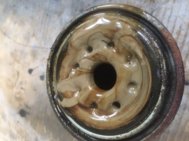

Yeah those turbos are prone to all sorts of issues over time - all hoses seals and fittings are prone to age and heat degradation from the turbo.  More heat, more parts, some weak design considerations, the stats are highly against old gen turbos.
Pull the manifold and look for oil/coolant in the exhaust manifold from a head crack.
Headgasket is obviously another possibility. Common failure too.
Let’s hope it’s head gasket.
Had one go on a previous Xt but that was letting water into the cylinder and making a load of steam at the exhaust. I’m guessing water into the oil is going to be worse
I'm probably going to pull the engine out for investigation or I'm considering doing a transplant with a different engine.
Was wondering which engine would drop in with the minimum amount of fettling???
the intake gaskets can also leak into the cylinders - that's far less problematic in some ways...although that pic looks really b ad.

So the engine is out and I've found the culprit.
One of the freeze plugs had popped out in the head.
Just waiting for my water pump to arrive and I can do a pressure test on the cooling system to see if I need to delve deeper.
Dropped the sump off and apart from a load of milky oil laying in the bottom it looks like the crank is in good condition.
Also managed to free off the completely stuck distributor, given a clean up and back in.
Good weekend so far.
  • Like 2
^ that’s a win in my book!
Run it with quick oil change intervals to clean the milky crud out of the engine.
Drop a bore scope into the cylinders to make sure they’re not full of milky oil.
You may need to pull the heads to clean the cylinders out yet. I had to do the same on my EA81 that did the same thing as yours there.
