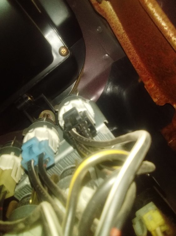

xXArchusXx Posted October 10, 2020 Author Share Posted October 10, 2020 5 hours ago, idosubaru said: There’s a rack of relays above the fuse box down below the drivers left foot. Check those? All the relays there are the same, swap one one to test. Or it’s under the ask tray, I’m forgetting. This thing? Link to comment Share on other sites More sharing options...
idosubaru Posted October 10, 2020 Share Posted October 10, 2020 12 minutes ago, xXArchusXx said: This thing? Yes I think that’s it. The photo is so close I can’t see any reference points but that appears to be a stack of relays. it’s down in the drivers footwell looking up. I’m not positive the relay you need is there but I think it might be. how positive are you that the relay is the problem? It’s fairly common for people to ask where a part is only to find out later that it wasn’t the issue. Link to comment Share on other sites More sharing options...
xXArchusXx Posted October 10, 2020 Author Share Posted October 10, 2020 14 minutes ago, idosubaru said: Yes I think that’s it. The photo is so close I can’t see any reference points but that appears to be a stack of relays. it’s down in the drivers footwell looking up. I’m not positive the relay you need is there but I think it might be. how positive are you that the relay is the problem? It’s fairly common for people to ask where a part is only to find out later that it wasn’t the issue. The lights turn on when u use turn signal doesn't flash and the hazards don't flash. It is 32 year old car after all. Where can I get a diagram for the fuses? Link to comment Share on other sites More sharing options...

xXArchusXx Posted October 10, 2020 Author Share Posted October 10, 2020 18 hours ago, idosubaru said: Yes I think that’s it. The photo is so close I can’t see any reference points but that appears to be a stack of relays. it’s down in the drivers footwell looking up. I’m not positive the relay you need is there but I think it might be. how positive are you that the relay is the problem? It’s fairly common for people to ask where a part is only to find out later that it wasn’t the issue. The pic is to the left of the brake pedal USDM. What else could it be? Unplugged each thing one at a time and the hazards still worked. Link to comment Share on other sites More sharing options...
idosubaru Posted October 12, 2020 Share Posted October 12, 2020 On 10/10/2020 at 3:43 PM, xXArchusXx said: The pic is to the left of the brake pedal USDM. What else could it be? Unplugged each thing one at a time and the hazards still worked. “the hazzards still worked”. I’m not being a troll - trying to clear up exactly what to look for. The hazzard (and blinker) lights are coming on but not flashing? If that’s the case, I would check the bulbs and sockets for corrosion. Even a working bulb can rarely cause issues with wiring, dash lights, and control button/switch functionality as it changes the current and resistance of the circuit. I’m traveling and can’t turn on my laptop to look up the hazzard wiring (relay or timer?) specifics. Link to comment Share on other sites More sharing options...
