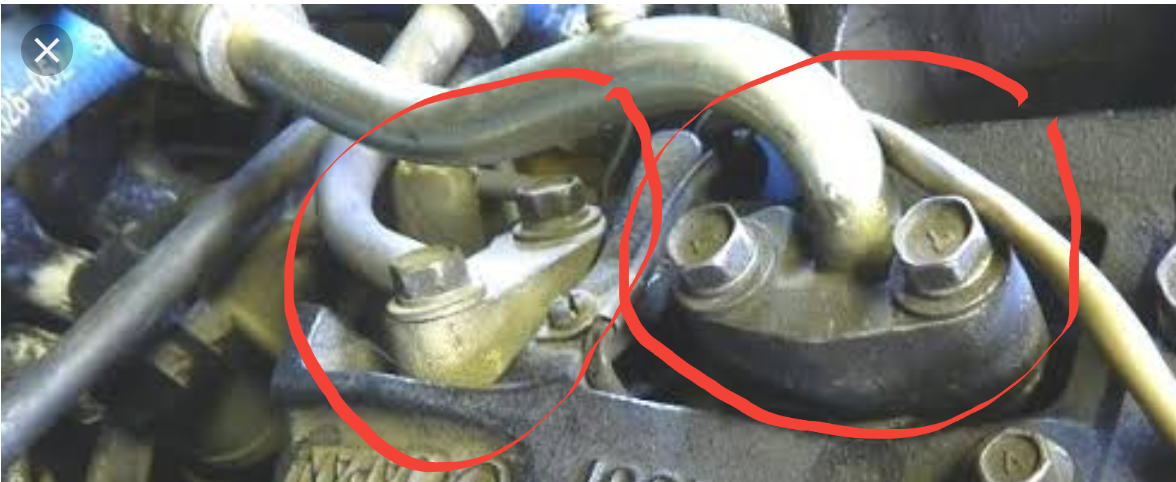

Non Culpa Posted November 13, 2020 Author Share Posted November 13, 2020 Rampage, photo as per my PM. Regards Dennis Link to comment Share on other sites More sharing options...
Rampage Posted November 13, 2020 Share Posted November 13, 2020 I don't know if they have a real name or not. I call them the a/c hose connector for the compressor. You said they were cut off on yours. The only way I know of to get them now is from a scrap yard or junk yard as the complete hose assembly for your cars compressor. They must fit the compressor on your car. There are a lot of different shapes and sizes for different compressor models. The smaller diameter metal pipe is the High side (pressure) hose that goes to the condenser. The larger diameter pipe is the Low side. If the metal pipe was cut on yours and you can find the connectors that fit your compressor and if there is enough pipe to work with, you can use a Flare fitting coupler to couple the metal pipes. Link to comment Share on other sites More sharing options...
