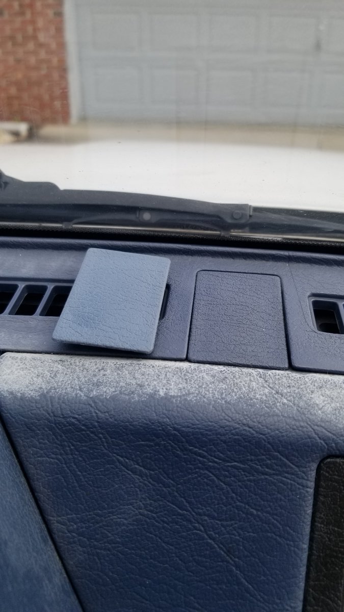

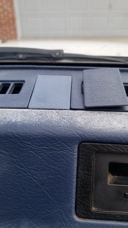

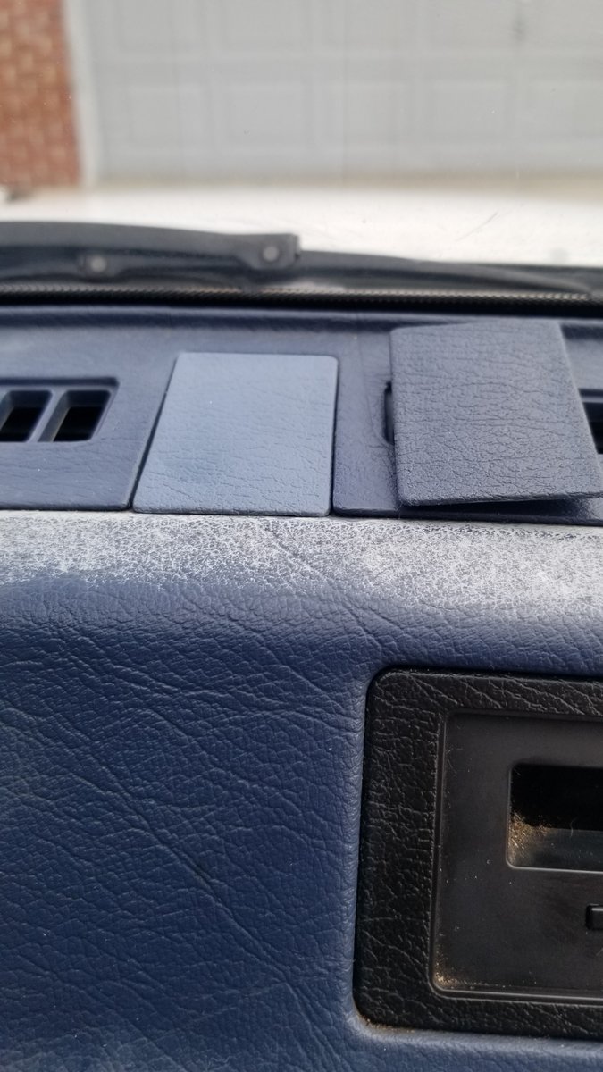

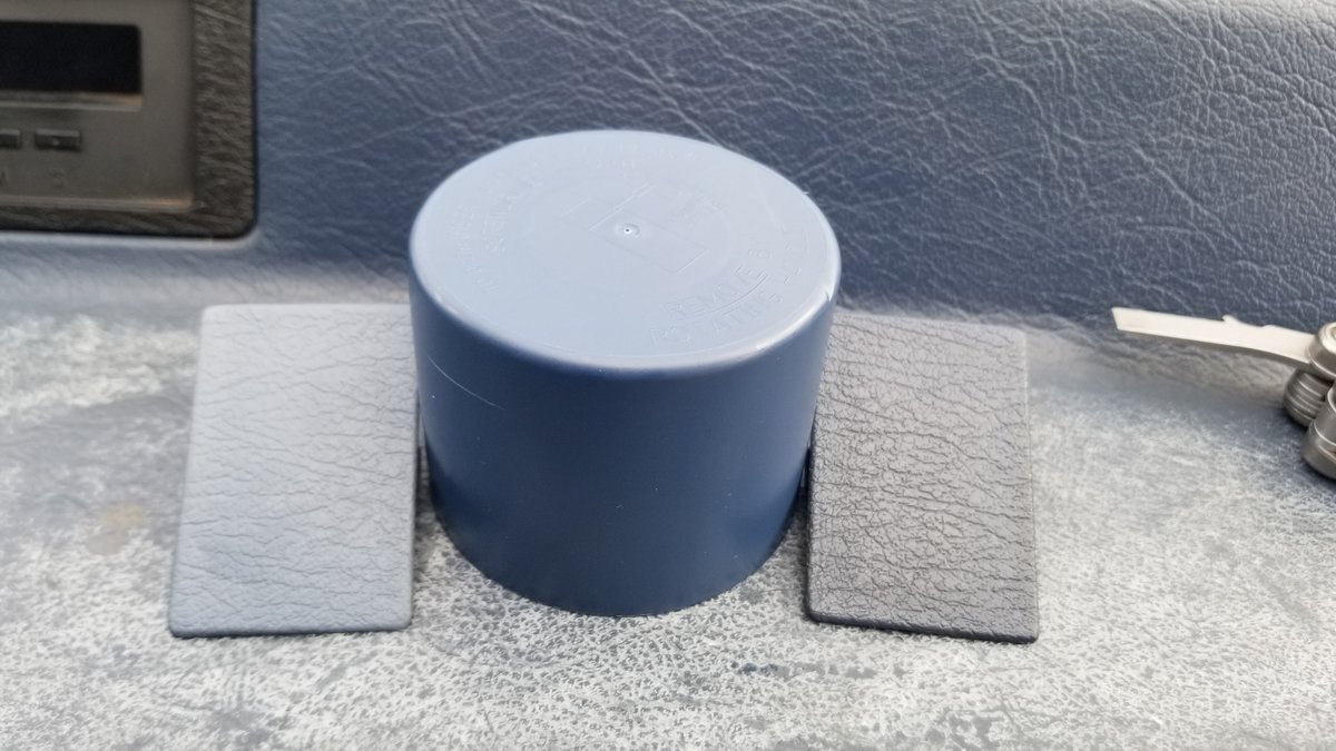

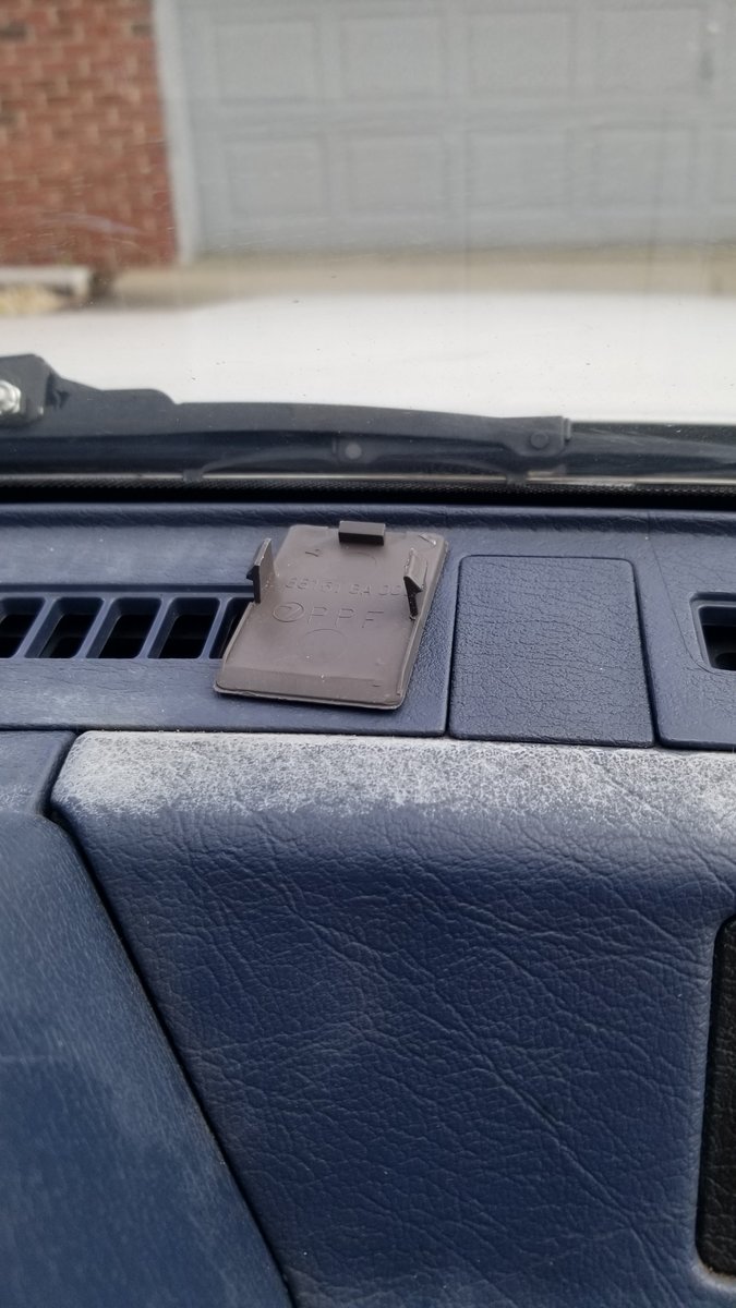

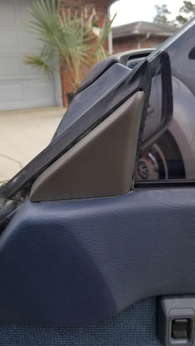

Ionstorm66 Posted October 27, 2020 Share Posted October 27, 2020 (edited) So my dash is extremely sun beaten and a few other parts I've replaced because the blue was cracked. My parts car has great plastics but it's brown. So I decided to give this paint/dye stuff a try. The color on the can cap was way off, but the end product is so close once it's all done you won't be able to tell. I put 2 coats on both parts and after 4 hours of drying I can't scratch it off with a finger nail or plastic trim tool Left is the painted and right is the original with the cap: Original with painted next to it: Painted one installed: The under side of the painted one: Edited October 27, 2020 by Ionstorm66 1 Link to comment Share on other sites More sharing options...

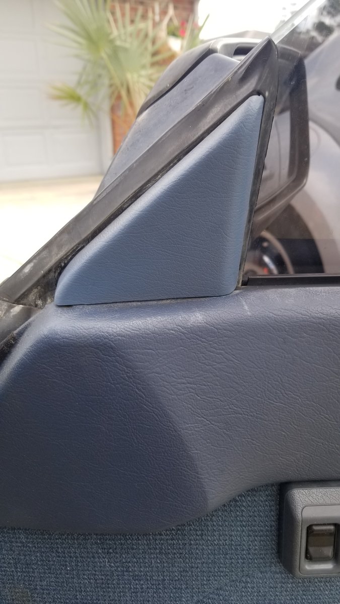

Ionstorm66 Posted October 27, 2020 Author Share Posted October 27, 2020 (edited) Here is the mirror trim. You can't even tell the color is off with the vinyl next to it. Original color: Edited October 27, 2020 by Ionstorm66 1 Link to comment Share on other sites More sharing options...

Ionstorm66 Posted October 27, 2020 Author Share Posted October 27, 2020 2 hours ago, Dee2 said: What's the name of the paint/dye stuff ? Dupli-Color Vinyl and Fabric Coating in Medium Blue. Got it at O'Reilly's. I just scotch brited them and washed with soap. I'm really amazed at how well it stuck. I plan on doing the dash pad in place. Link to comment Share on other sites More sharing options...
