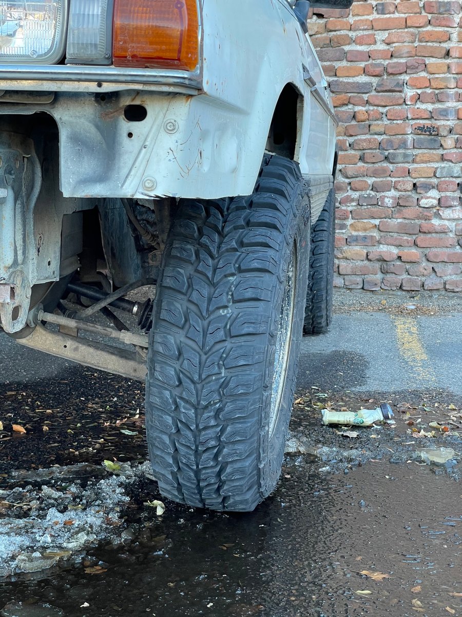

vesparex Posted November 11, 2020 Share Posted November 11, 2020 So I bought my car with a previously installed 4" lift. The front camber is awful. What have people done to try and reconcile this? Thanks, Duane Link to comment Share on other sites More sharing options...
GeneralDisorder Posted November 12, 2020 Share Posted November 12, 2020 Strut top extensions with correct offset. GD Link to comment Share on other sites More sharing options...
vesparex Posted November 12, 2020 Author Share Posted November 12, 2020 Thanks GD. Know of any suppliers for my old EA81? Duane Link to comment Share on other sites More sharing options...

GeneralDisorder Posted November 13, 2020 Share Posted November 13, 2020 Patrick can make them. They had them listed last I checked. We just received one a few months ago. GD Link to comment Share on other sites More sharing options...
