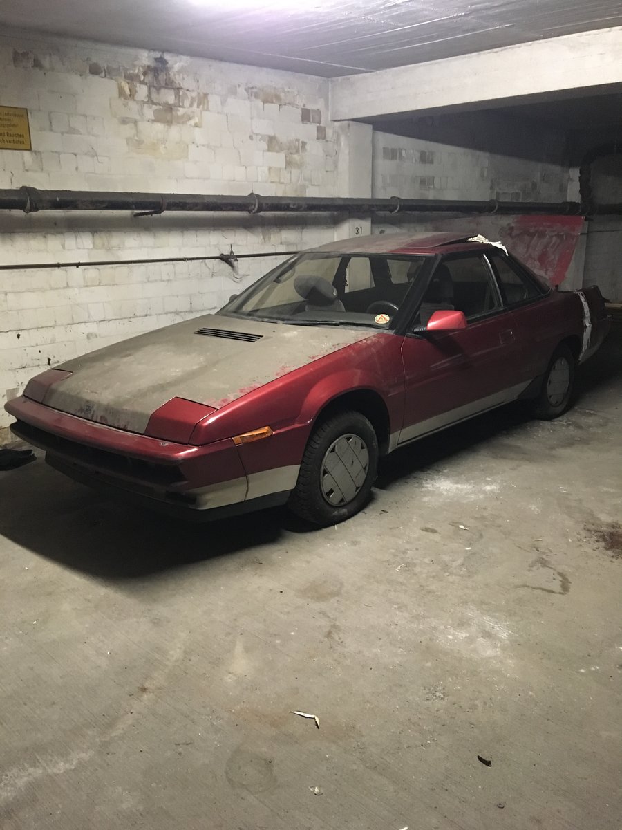

XT barn-finder Posted December 9, 2020 Share Posted December 9, 2020 Hey, i‘m from Germany and want to bring an xt Turbo back on berlin‘s streets. I found this nice piece of Engineering in a Garage, Sitting there for Almost his whole life, since The early 90ies. Unfortunately some Bad guys broke The passengers side rear window and as you can Imagine, there is no Parts anywhere to get for this exotic car. Does anyone of you can help me out? cheers Quote Link to comment Share on other sites More sharing options...

XT barn-finder Posted December 10, 2020 Author Share Posted December 10, 2020 hey idosubaru, I just called some dealers and Subaru Germany, they got the vin and promised to call me if there is something like a rear window to find. so I wait and we'll see. I've got another question: the fuel pump doesn't work and the gas is over 20 years old, so how could I start the car? I already tried with start pilot, but not succesfully. spark plugs are new and there is a spark on every plug, what is wrong when air, gas and a spark are in the game? do you have a clue? Quote Link to comment Share on other sites More sharing options...

el_freddo Posted December 10, 2020 Share Posted December 10, 2020 You’ll need a new fuel pump. It would be a good idea to remove and clean the fuel tank, replace all rubber fuel lines including those under the intake manifold. While the manifold is off replace all coolant hoses with new items. You could get it started first then do all the fuel and coolant hoses so you know for sure that it’s a runner to begin with. Alternatively, try some Aerostart to see if it will fire on that. Good idea to drain oil and assess its condition, replace with cheap stuff for the purpose of initial start up and giving it something fresh to lubricate with. If there’s water or coolant in the oil you have a head gasket issue. Cheers Bennie Quote Link to comment Share on other sites More sharing options...
john in KY Posted December 10, 2020 Share Posted December 10, 2020 The injectors are most likely now not passing any fuel and need to be removed and cleaned. Same for the fuel filter. Engine will never start on 20 year old fuel. 1 Quote Link to comment Share on other sites More sharing options...

idosubaru Posted December 10, 2020 Share Posted December 10, 2020 5 hours ago, XT barn-finder said: hhe fuel pump doesn't work and the gas is over 20 years old, so how could I start the car? drain all the gas you can from the tank and lines in the vehicle. install new fuel filter and fuel pump. injectors should be tested at a minimum (if that's possible, i've never heard of anyone testing them) or cleaned. over here there are companies that clean injectors. i think John has used this company before: https://www.witchhunter.com/ I'm not sure if old gas can harm the fuel pressure regulator but I would ask if there's any way to clean or test that. Quote Link to comment Share on other sites More sharing options...
