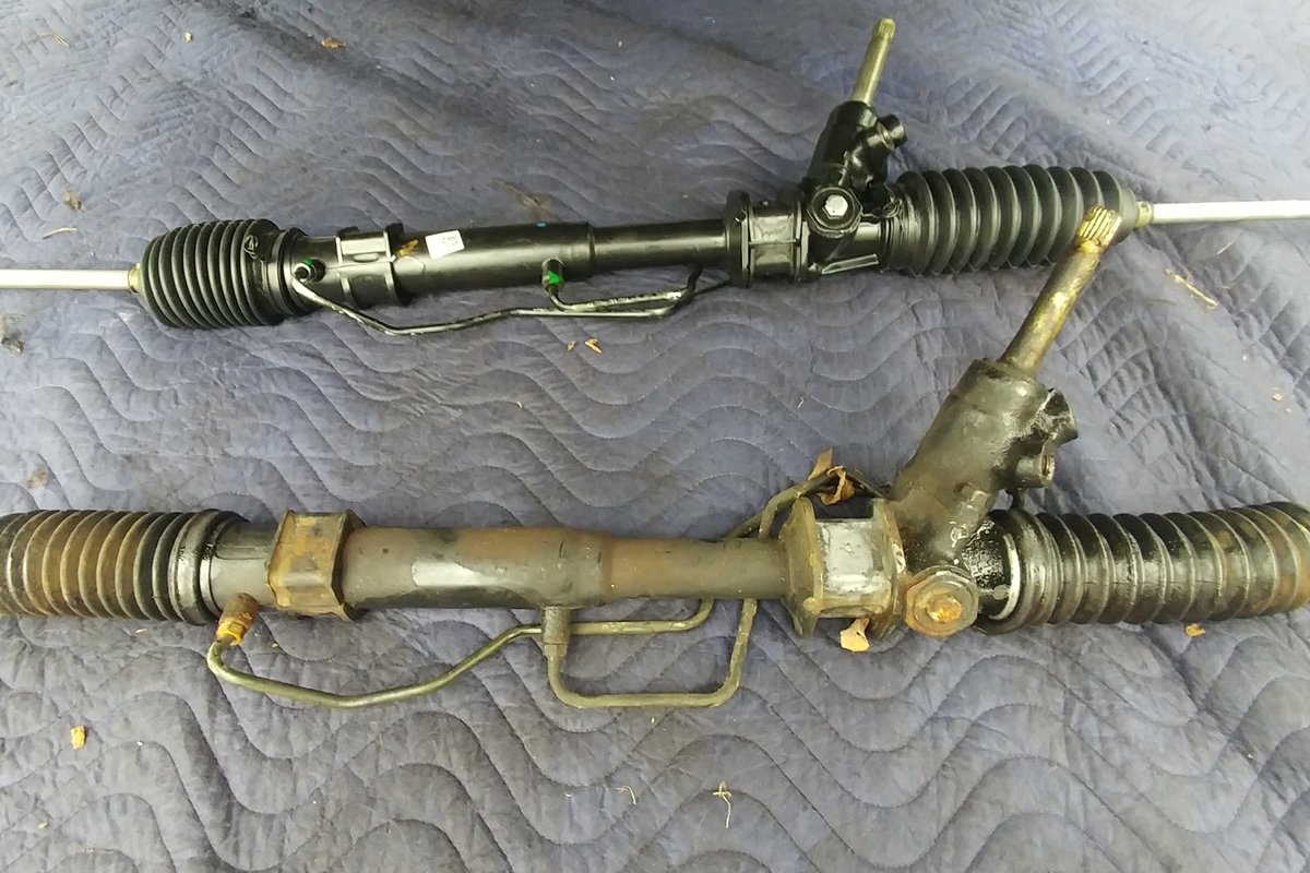

usrdltd Posted December 12, 2020 Share Posted December 12, 2020 I've searched everywhere. Found a couple on Amazon. It was expensive and I don't even know if it will fit. The in/out lines don't look like they are in the right place. It's raining now or I'd be trying to put it on. Does anyone know a reputable place to get parts for my late model? Link to comment Share on other sites More sharing options...
Ionstorm66 Posted December 12, 2020 Share Posted December 12, 2020 Is the GL-10 rack the same as a normal rack? I don't think anyone rebuilds them anymore for sale. A local shop might be able to rebuild it, or find a good used unit. Link to comment Share on other sites More sharing options...
usrdltd Posted December 12, 2020 Author Share Posted December 12, 2020 25 minutes ago, Ionstorm66 said: Is the GL-10 rack the same as a normal rack? I don't think anyone rebuilds them anymore for sale. A local shop might be able to rebuild it, or find a good used unit. I'm not sure about it being the same as a normal rack. I bought a rebuilt through Amazon for 350. Amazon was the only place it was available. The page said it will fit. I will probably rebuild the one I'm removing and selling it to make some of that loss back. The rebuild is just going to be tedious. My only other option would be to drain my fluid and run without power steering, but that'll ruin my pump. Link to comment Share on other sites More sharing options...
el_freddo Posted December 13, 2020 Share Posted December 13, 2020 You could run a set of fan belts without the PS pump in operation. I don’t know part numbers sorry. Any EA82 PS rack will be a direct bolt in replacement. They didn’t do anything special to the GL-10 racks. Cheers Bennie Link to comment Share on other sites More sharing options...
idosubaru Posted December 13, 2020 Share Posted December 13, 2020 I’ve bought EA82 racks not too long ago for like $100. Did your try Rock auto and eBay? Your best bet is to do a quick search on Subaru Online site, rock auto, a national chain and then ask here if you have any questions. Do not look for “one store” to supply all your old gen Subaru needs. That’s gonna suck. Link to comment Share on other sites More sharing options...
Loyale 2.7 Turbo Posted December 13, 2020 Share Posted December 13, 2020 18 hours ago, el_freddo said: ... Any EA82 PS rack will be a direct bolt in replacement. They didn’t do anything special to the GL-10 racks ... Despite that the statement is True: any EA82 Power Steering rack will be a direct replacement; there are three different ones for the L series; the difference is the inner diameter of the Rod, and you can notice it by the colour of the hydraulic seals; being the thinner rod with Blue seals, the intermediate rod with green seals and the thicker one came with red seals. I bet that it has something to do with the market where the subie was sold (according to the terrains it will be driven more often), not exactly on which engine it had mounted from factory. Kind Regards. Link to comment Share on other sites More sharing options...
naru2 Posted December 13, 2020 Share Posted December 13, 2020 and XTs have 2 more different ones(early and late).not counting the electronic one. According to the parts book,the 3 non XT ones vary by year:85-86,87,and 87 up 1 Link to comment Share on other sites More sharing options...
usrdltd Posted December 13, 2020 Author Share Posted December 13, 2020 21 hours ago, idosubaru said: I’ve bought EA82 racks not too long ago for like $100. Did your try Rock auto and eBay? Your best bet is to do a quick search on Subaru Online site, rock auto, a national chain and then ask here if you have any questions. Do not look for “one store” to supply all your old gen Subaru needs. That’s gonna suck. Rockauto's only option was for me to send them mine to be rebuilt. Better price, but it's a daily driver. Amazon was the only place I could find one in stock. I tried everywhere including the local dealership. I joined this site to see what options anyone else had found. Link to comment Share on other sites More sharing options...
usrdltd Posted December 13, 2020 Author Share Posted December 13, 2020 The part from amazon is in now. minus a stripped bolt on the steering knuckle, which I am going to get tomorrow, and the fluid lines. Got that stripped screw and called it a night due to the darkness. Link to comment Share on other sites More sharing options...
usrdltd Posted December 13, 2020 Author Share Posted December 13, 2020 Link to comment Share on other sites More sharing options...
idosubaru Posted December 14, 2020 Share Posted December 14, 2020 Good glad you’re all done with it. Motor on. Link to comment Share on other sites More sharing options...
