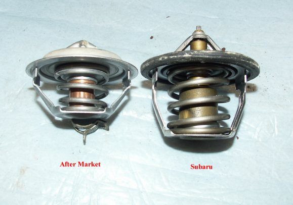

1 Lucky Texan Posted December 17, 2020 Share Posted December 17, 2020 hope the new thermostat is OEM style. Quote Link to comment Share on other sites More sharing options...
