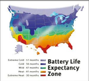

The chart is kind of hard for me to see but if I am reading it correctly, interesting that it shows batteries for the most part lasting longer in colder climates, where I am. I believe the battery in my truck is N/G - it's been slow to start and had to charge it yesterday. The truck started, but wouldn't again. I hope it is the battery and not the charging system. Saw the date - May 2014 so the battery is probably shot.
I know this is a Subaru forum but it's good to find a battery reference here that can be applied elsewhere. AAA will tend to get many calls when it's cold - that's why I always assumed cold climates reduced battery life. But I guess there's other factors when it's cold
Expand
good observation, the chart says 56 months for cold, but 30 months for extreme heat, is that correct?

Share on other sites
Expand
yes, in cold climates, you need CCA, in hot climates, you want reserve capacity. Plus, everytime a battery goes completely dead, sulphation occurs on the plates and that further reduces lifespan.
just Google automobile battery life expectancy or lifespan, etc. I live in DFW area, if I get 3.5 or 4 years from a battery, I will dance a jig like I invaded Paris!
