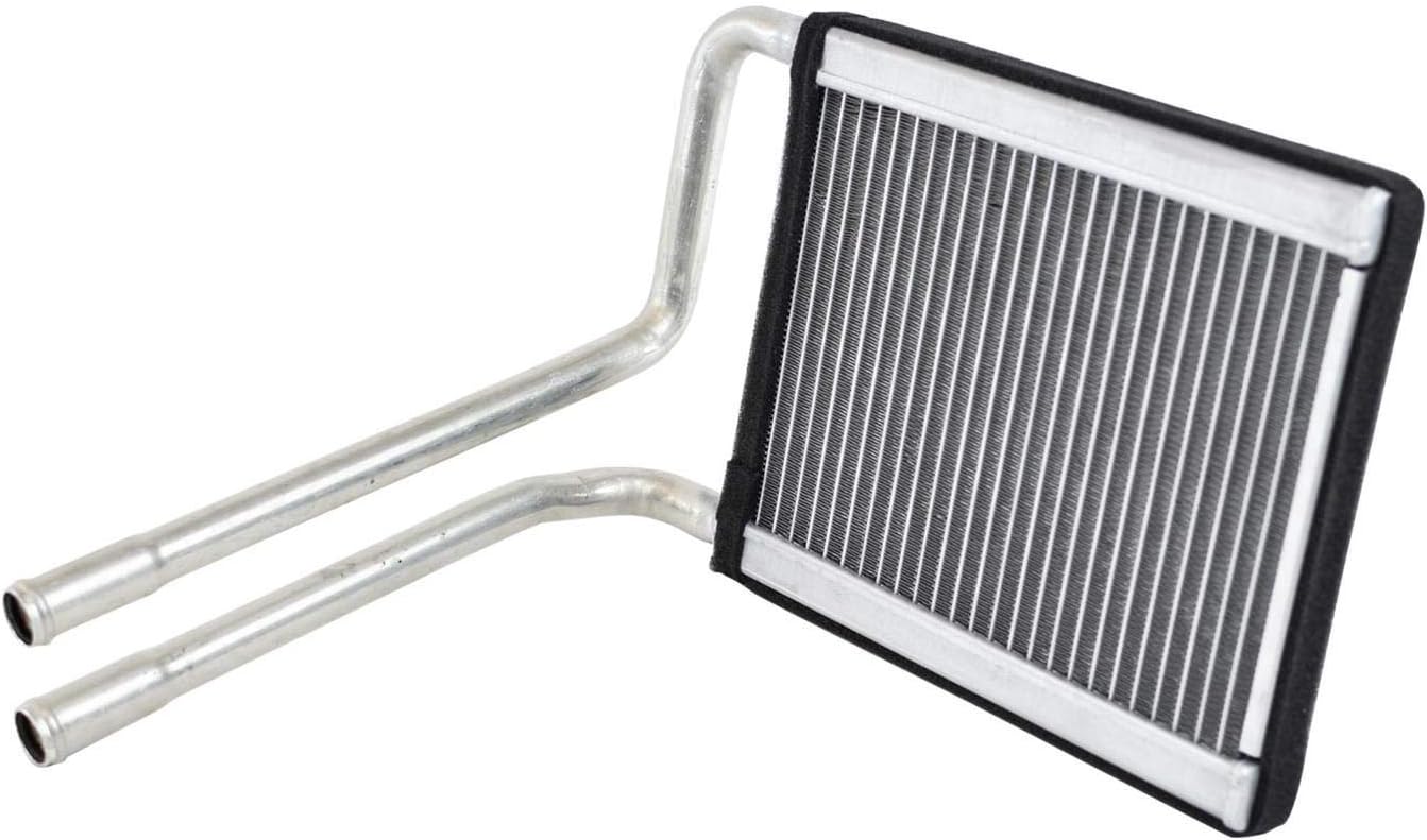

turbodog Posted January 6, 2021 Author Share Posted January 6, 2021 so heres the external cooler for after the turbo installed... fits super nice 1 Link to comment Share on other sites More sharing options...
el_freddo Posted January 7, 2021 Share Posted January 7, 2021 Nice looking radiator, I’d be putting it behind the AC and main radiator if possible - you want to waste a bit of heat from the turbo, not then heat up cooling air for the AC condenser and main radiator. Hopefully you can mount it behind everything once the engine is in place. Cheers Bennie Link to comment Share on other sites More sharing options...

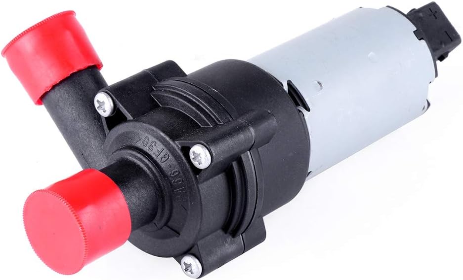

turbodog Posted January 8, 2021 Author Share Posted January 8, 2021 so i was a little worried that the extra coolant hose length would not allow enough flow so i picked up an auxillery coolant pump from like an audi or vw, this should keep things flowing good. also picked up a second elextric fan 1 Link to comment Share on other sites More sharing options...
1 Lucky Texan Posted January 8, 2021 Share Posted January 8, 2021 Man, I dunno, is the expected gain in power gonna be more than the loss from the xtra mass you are adding? still, good looking installation. Link to comment Share on other sites More sharing options...
turbodog Posted January 8, 2021 Author Share Posted January 8, 2021 On 1/8/2021 at 5:11 PM, 1 Lucky Texan said: Man, I dunno, is the expected gain in power gonna be more than the loss from the xtra mass you are adding? still, good looking installation. Expand not really looking for a gain in power just looking for a gain in more stable cooling, hopefully itl keep that side of the engine cooler, seeing how its usually the hottest side and its normally the first to blow a headgasket 1 Link to comment Share on other sites More sharing options...
